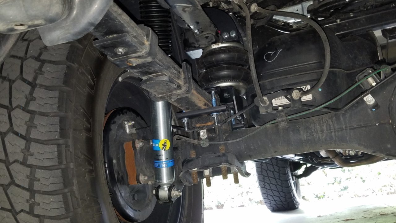

    I have a 30k service due in about a month... perhaps I will rattle some cages and see what I come up with. The attached picture will be their strongest weapon!
