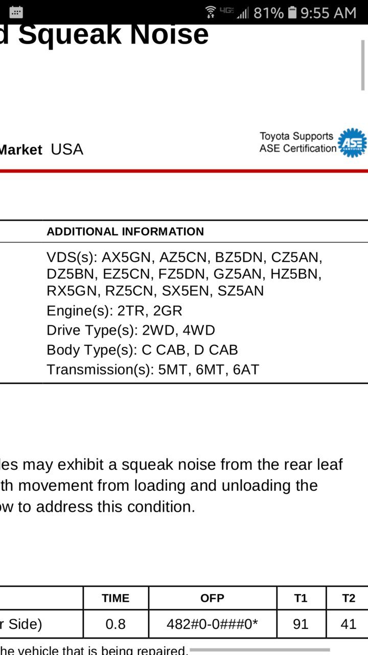

    Are these VDS (S), part of the VIN #?
  9. Jul 10, 2018 at 7:25 AM
    #149
    Hemlocktherm78
    Hemlocktherm78 Well-Known Member
    Jan 4, 2018
    #240267
    518
    Also, when I do the recall VIN enter on Toyotas website, it says no current recalls or service campaigns for my Tacoma.
    Do they only have TSBs as a fix for complaints?
    I have the CZ5AN as part of my VIN which is part of the leaf spring TSB.
    thanks
