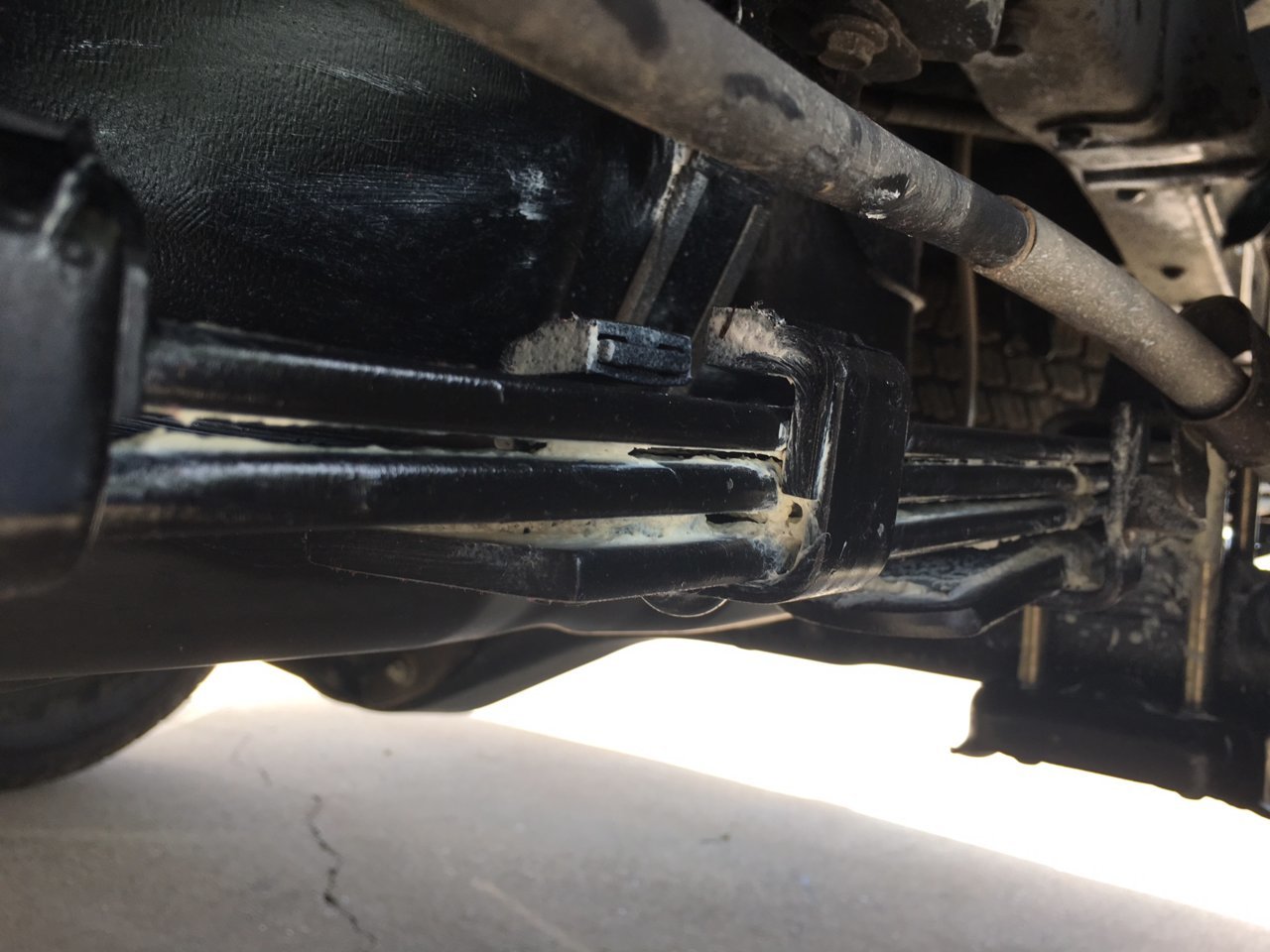

    I just got back from the dealer. I showed him the TSB (Rev 1), he produced his own copy (Rev 2) which also applies to 2018, but has a listing of VINS to which the TSB applies before the "Production Change Effective Date." He used that table to tell me my VIN wasn't listed. At first, I took it at face value. In the truck, I took a closed look....page one of the TSB was stapled as the last page. Page one showed the same applicability VINS. So I went back, explained I think the tech was wrong on the VIN range applicability. Long story short got the service manager involved and they double checked and it is still applicable to my truck (2017). No apologies, just the silent treatment from the service adviser. I asked for paperwork so we can document the service request, he said I could wait an hour as he's going to lunch! Look forward for the customer satisfaction survey buddy!
    Got the parts ordered (apparently on backorder to the dealers who give a shit or have forum reading owners).
    But they had already greased the hell out of the springs, a nice temporary fix but which is surely going to attract more muck over time. More for them to clean when they do the TSB I suppose.
