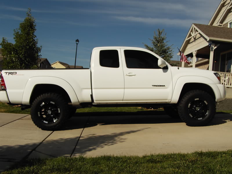

    Dude, your truck looks perfect :thumbsup:. I want my truck to sit the exact same way

    ^Yeah, that's what I'll be doing shortly. To me, that's how it should look OEM.
