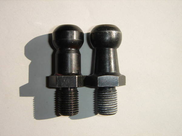

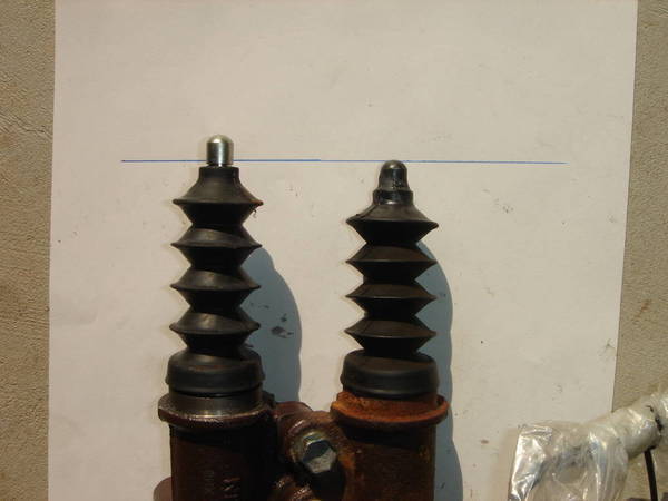

    In case you're curious, here are some pics of the old and new parts that are in the Toyota TSB. I had my transmission out for a different issue and put in the parts myself, I didn't want to wait for it to start chirping.
    Highlights:
    • The new TB is shorter (right side in pic)
    • The clutch release cylinder is longer (left side in pic)
    • The clutch fork support is rounder and fits more tightly in the clutch fork (left side in pic)
    So they changed the geometry enough that the bearing travel is in the middle of the arc instead of forcing it to the side into the housing quill which was causing the premature wear and wobble. 25K miles and chirp free for now ... check back in 5 years for the long term test results.
