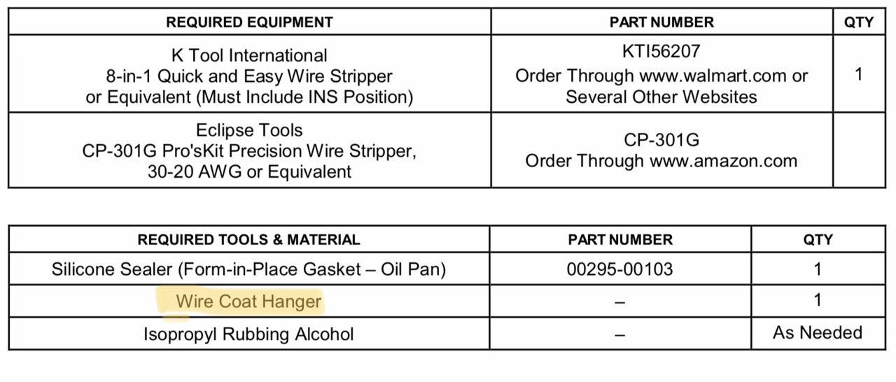

    Love the official tools listed for this TSB

    Needed to route harness through firewall grommet
    This is the first tsb I’ve seen where they may not even be able to duplicate prior to repair- essentially going off your word. This seems like something that would be good to have regardless. I’m order for them to test operation they put a cardboard to block air flow so I’m guessing high heat causes the same thing?

    I'm a Millionaire! One Million Posts!!
    "Isopropyl Rubbing Alcohol" . . .
    Priceless!

    Black '17 OR
    Those wire strippers are garbage
