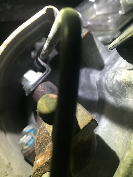

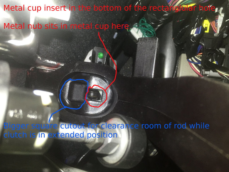

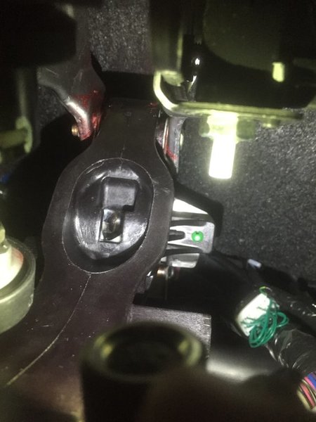

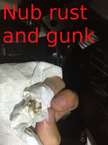

    I worked on fixing my pedal squeak inside cab.
    Here is how I solved mine for the time being.
    Pedal feels like new and silent inside cab. Now I notice alittle squeak outside underneath the cab somewhere. I've read about a rubber boot somewhere under there but haven't been able to locate it?? Any pics would be appreciated.
    IMG_6483.jpg IMG_6486.jpg IMG_6489.jpg IMG_6493.jpg IMG_6503.jpg IMG_6508.jpg

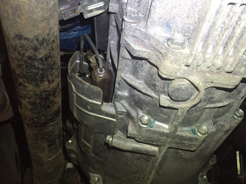

  11. Aug 7, 2015 at 10:13 PM
    #71
    Taco Pete626
    Taco Pete626 Well-Known Member
    Dec 31, 2012
    #94116
    623
    Peter
    Southern California
    2013 Regular Cab 5-spd (Sold )
    - Undercover Flex tonneau cover - Pop N Lock tailgate lock - Weathertech DigitalFit floor liner - Sick Speed Ol' Skool white shift knob - Bench seat mod - Wiper mod - Cruise control mod

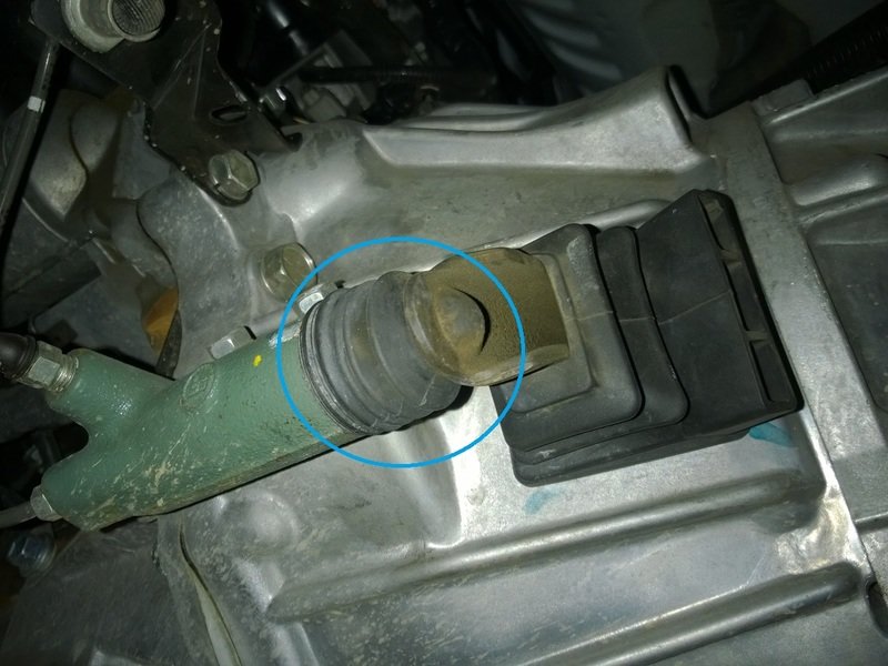

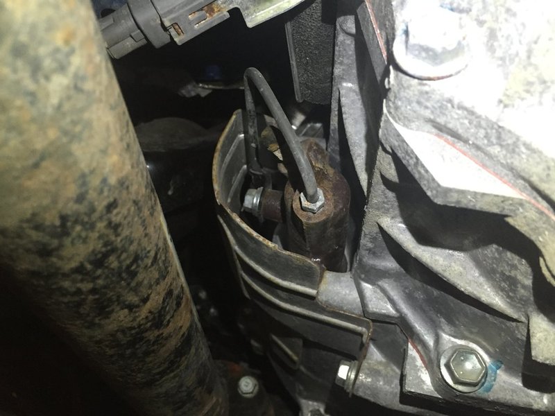

    Wow, nice write up! I've been wanting to do this for awhile, but didn't know what to remove and in what order. This helps a lot. As for the noise outside, look underneath the truck, look for the slave cylinder on the left side. The noise is coming from the slave cylinder actuating rod and the throw-out lever. I shoved some synthetic grease in the boot, closed it up, massaged it and the squeak was gone. Probably be best to remove it somehow, like what you did with the clutch pedal, but i think that requires removing clutch lines. You seem very mechanically inclined, so maybe you can find a better solution.
    The pic is below, circled in blue is area where the noise is coming from.
    scottalot likes this.
  12. Aug 7, 2015 at 11:11 PM
    #72
    jucara
    jucara Member
    Jul 2, 2008
    #7705
    20

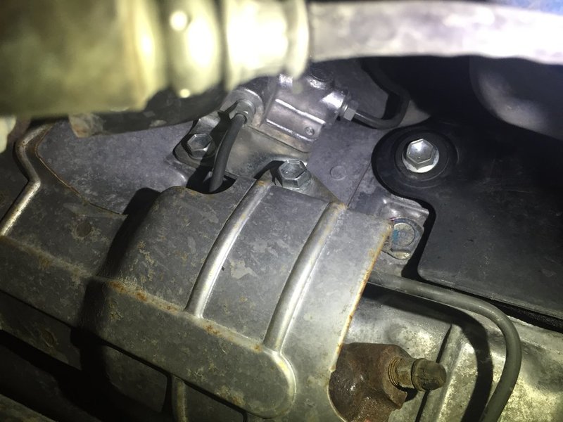

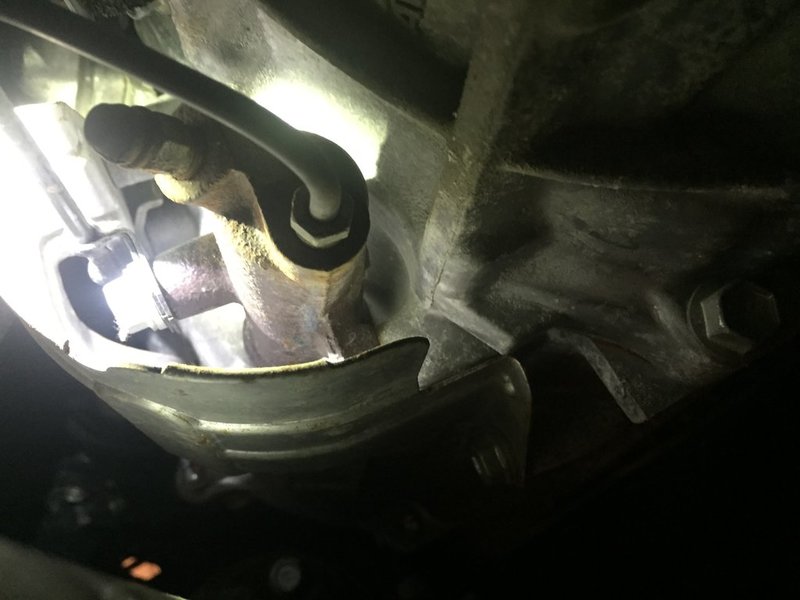

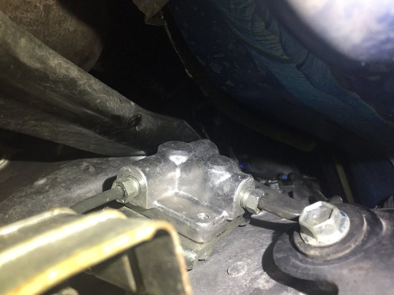

    I drive an 08 4x4 4.0 w 6 speed, I don't see that under my truck?
    Here is what I have below, no rubber boots or actuator rods I can find?
    IMG_6514.jpg IMG_6515.jpg IMG_6516.jpg IMG_6517.jpg IMG_6518.jpg IMG_6519.jpg

    Ah, unfortunately I have the 4 cyclinder 5-speed tranny. Hopefully someone else with a 6-speed can chime in. Not sure if the set up is similar, but you can try removing that shield and see whats underneath.

    #7705
    20
    awesome find!! There is a rubber boot inside there!! I will give it a shot and see what happens thank you
