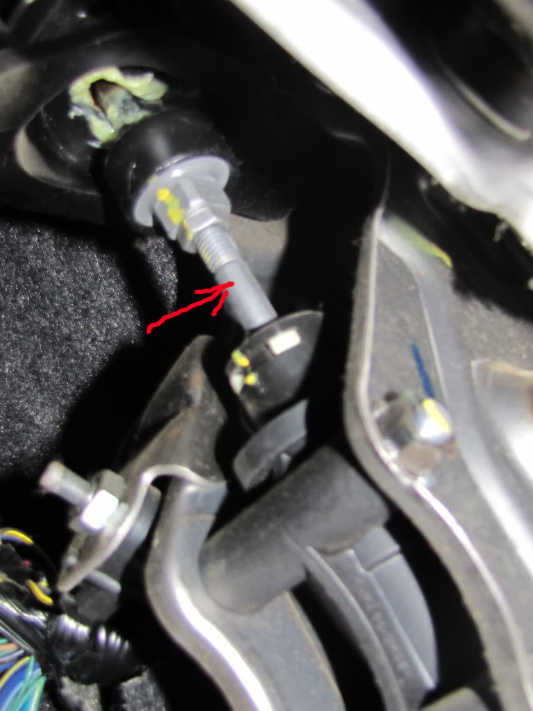

    yah, I'm short and stocky and I just about cant hardly get to it without removing the driver's seat, I did finally get to it and took a small pair of vicegrip pliers and tightened up the rod and the squeak has been gone for over a year now.

    Thanks for all that posted and providing more information.. bluezzy... I doubt you want to go under the dash again and point to where you did the tightening... the issue is that in your head...you know what part you are describing, but as someone who don't have that image in their head...hard to understand what part to tighten. Maybe if anyone can do a hand drawing and say...this location do this...would go a long way to seeing if this fix would help me.
    Last time I was under the dash...I grease several places, but none of it helped...the dealer... it worked for several months...I don't mind doing that...if I knew exactly where...and yeah it is a pain being contorted trying to figure out...so more information would be appreciate and thank you again for all that posted.

    I greased the crap of that area before and again today...no difference. I also spent another 20 minutes and grease all over...no difference. I think the squeak is coming from the bolt where the clutch pedal pivots. I didn't want to try to remove it in case it pops out of place with the spring and have the truck not running. I haven't ever removed clutch pedal before so I didn't want to risk it without seeing how it's done first. I would bet money that the squeak is in that bolt/axle.

    yah, I didnt take it apart or nutin, I just got a pair of vise grip pliers up in there and gave a few cranks, damn near broke my back doing it but it dont squeak any more.
