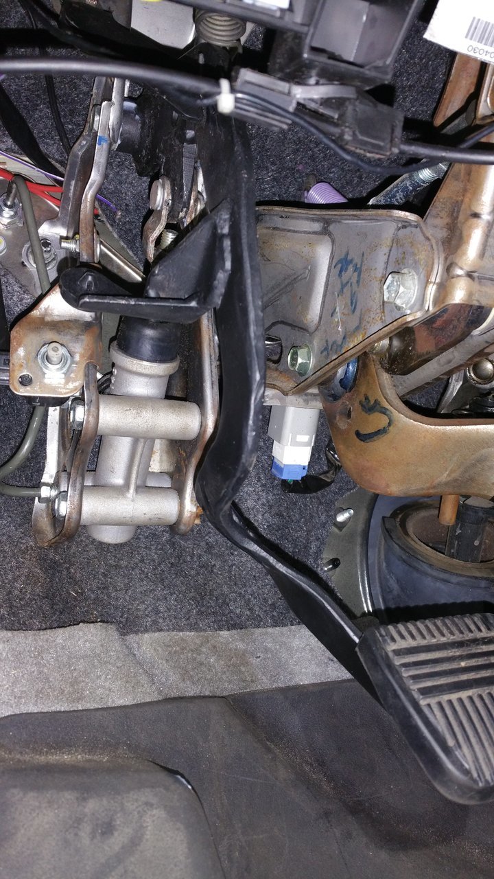

    I fixed my clutch pedal problems permanently...
    Beck Arnley alloy master cylinder, FJ cruiser steel clutch pedal with clevis (modified) , linear spring, stainless braided clutch flex line.
    No more noise, easier throw, no more master cylinder sticking to the floor when it's cold, and the clutch throw itself is significantly reduced, I can use the clutch and keep my heel on the floor the whole time.20171212_030835.jpg

    The pedal took some heavy modification to make work, lot's of cutting welding and tweaking angles and arms on the pedal body. This may have been because I am still using a Tacoma MC when the FJ MC is slightly different, I did not realize this at the time, in the future I'd like to buy a FJ MC and compare it to the Taco MC. I know they have a different attachment point to the pedal. The taco used that lame squeeky ball and cup and the FJ uses a clevis. I made a small clevis I had in my garage and welded a tab onto the FJ pedal to make it all work.
    Again I still have a Tacoma specific master cylinder, it just isn't OE, it's a Beck-Arnley from Amazon. I got it because it is aluminium vs the plastic OE one. The plastic one is too susceptible to cold weather and swelling when hot, this leads to a vague clutch feel and potential bypass of fluid around the piston seal. The ball and cup coming apart is what allows the MC rod to get stuck on the bottom while the coil spring returns the pedal body to the up position.
    So I have basically a custom pedal, a Tacoma MC with a clevis on the rod and an aluminium master cylinder.
    Hope that helps, I can get pictures tomorrow.

    Thanks for the reply, but too much custom work when I don't have the tools to do it. I know how to weld from welding class, but no tools to do what you did. If it was just stock replace items then would be more manageable. If the FJ master clutch cylinder was a drop in replacement then yeah...would be interested in doing it. Just wish Toyota didn't do this lame plastic clutch parts.
    Interesting, but too big of a project for what I got going on right now...thanks again.

    Once I get settled into my new place I'm going to order an FJ MC and see if the angle is any different with the mounting holes etc, may order another FJ pedal too, it was only like $30 IIRC. I'll update here if it works out without all the custom fitting.
