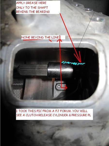

    Ok gentleman I have a temporary fix from the annoying chirp or churp from the throwout bearing. Ok so you'll need a grease gun and some high temp bearing grease. A 24" grease hose that is flexible. And a socket First take off the clutch housing cover which is located on the bell housing right next to the clutch release cylinder. It's like a viewing window to the soul of this little-big problem. Anyways. This next parts cake.... Once the cover is off let your Gf help you. So she feels special! Tell her to push the clutch pedal in. (Make sure she's not pushing the break. This is very important baa ha ha). Sorry. Ok so after the clutch pedal is pushed in. Stick your grease line in behind the throwout bearing and try put a nice bead of lube on the shaft. (quill). I put a little tiny dab on the top of my bearing but you don't have to because you don't want to get any of this to close to the pressure plate. It worked with just putting some on my shaft (quill). I just did it for a little extra precaution. It worked and this was about 4 days ago and no chirp since then. Total cost to me. 10$ for gun grease and 24" long 3/8" grease line screw the dealer they won't warrant it and knowing about the tsb and this is the 3rd throwout bearing and I'm only at 75k miles. So I was going to do the urd sleeve and make a DIY for it because I can't find one so far but decided to try this. It worked. Not sure how long it will last but I caution font go crazy with the lube you can't get any on the flywheel so be cautious of wear you out it. Ill try to find a photo and show you guys via Microsoft pain tools.

    [​IMG][​IMG]
