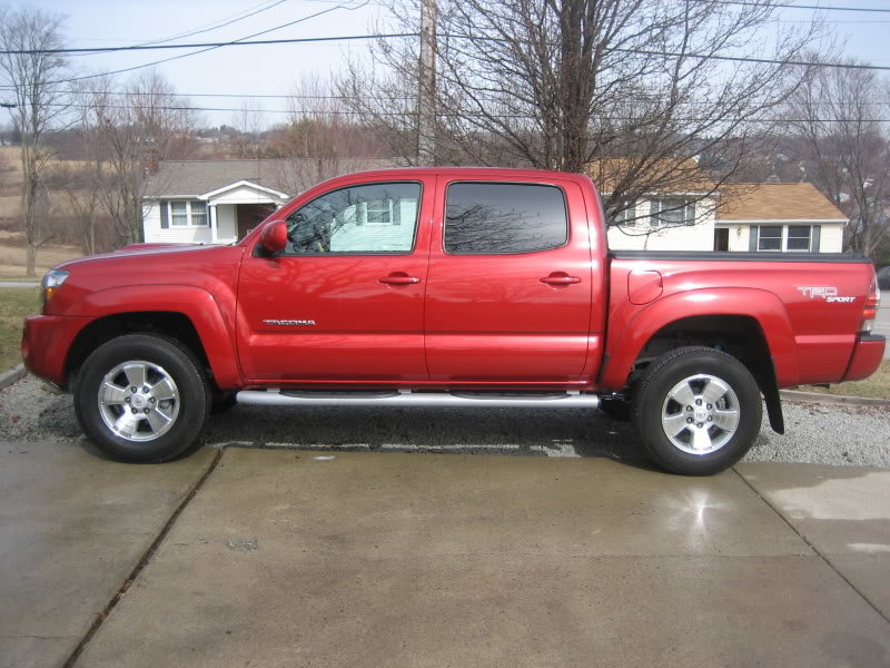

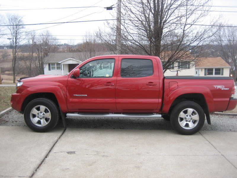

    Yes, many are burned out from discussing TSB issues. But, to others, the issue is new.
    I had the TSB on my 09 and I definitely notice the difference. My headlights are proof of the additional rake because they are now pointed painfully low. Once I learn how to adjust them...I will.
    I don't have measurements but do have pictures. Soon, I will order new Bilstein 5100's for all sides of my truck. I plan to set the front to 1.75". This should level the truck and may even eliminate the factory rake. I also plan to sell my stock TRD Bilsteins on ebay and recoup half the cost of the 5100's.
    Later, I will add a leaf in the back and move the front to 2.5".
    Before TSB:
    After TSB:
