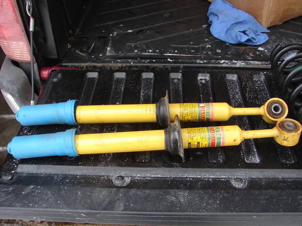

    I'm getting the TSB done in couple weeks the dealer said since the truck is a non-TRD I also get new front and rear shocks installed his thought was these will be upgraded shocks over the the originals does anyone know what the upgraded shocks are?

    You'll get the blue and yellow bilsteins that come on the TRD off road and sport models.

    That's correct since he has an '08. The 2009+ TSB says not to replace the shocks (but the dealer did on mine anyway).
