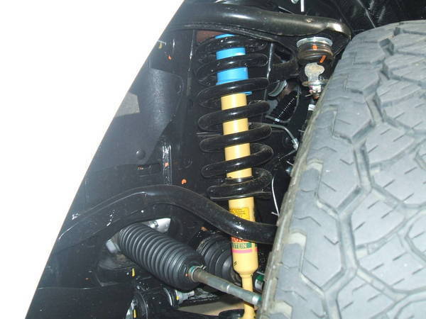

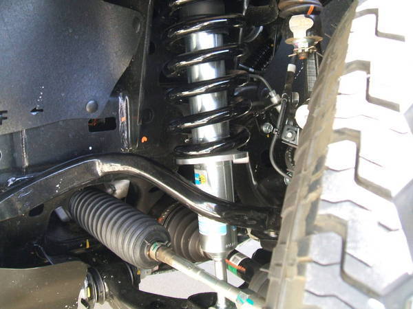

    The Bilstein TRD shocks you will receive with the TSB are the same with either package, difference being the coil springs used for the different packages, OR vs. Sport. That's my understanding talking to my parts manager??
    Anyway the Toyota factory TRD Bilsteins are still a fleet type shock, being about 40% smaller diameter than after market Bilstein's in either the HD "yellow" or the 5100 "silver" series.
    I replaced the factory TRD ones on my '99 after one blew after two years with the HD's and it was like night and day in ride quality. The '08 got the 5100's for leveling but still improved the ride over stock. IMO..
    TRD OR Bilstein also with TSB service
    Aftermarket Bilstein 5100 or HD shocks

    For the Billy's they use the 4600s
    upgrade to the 5100 series while you can. :)
