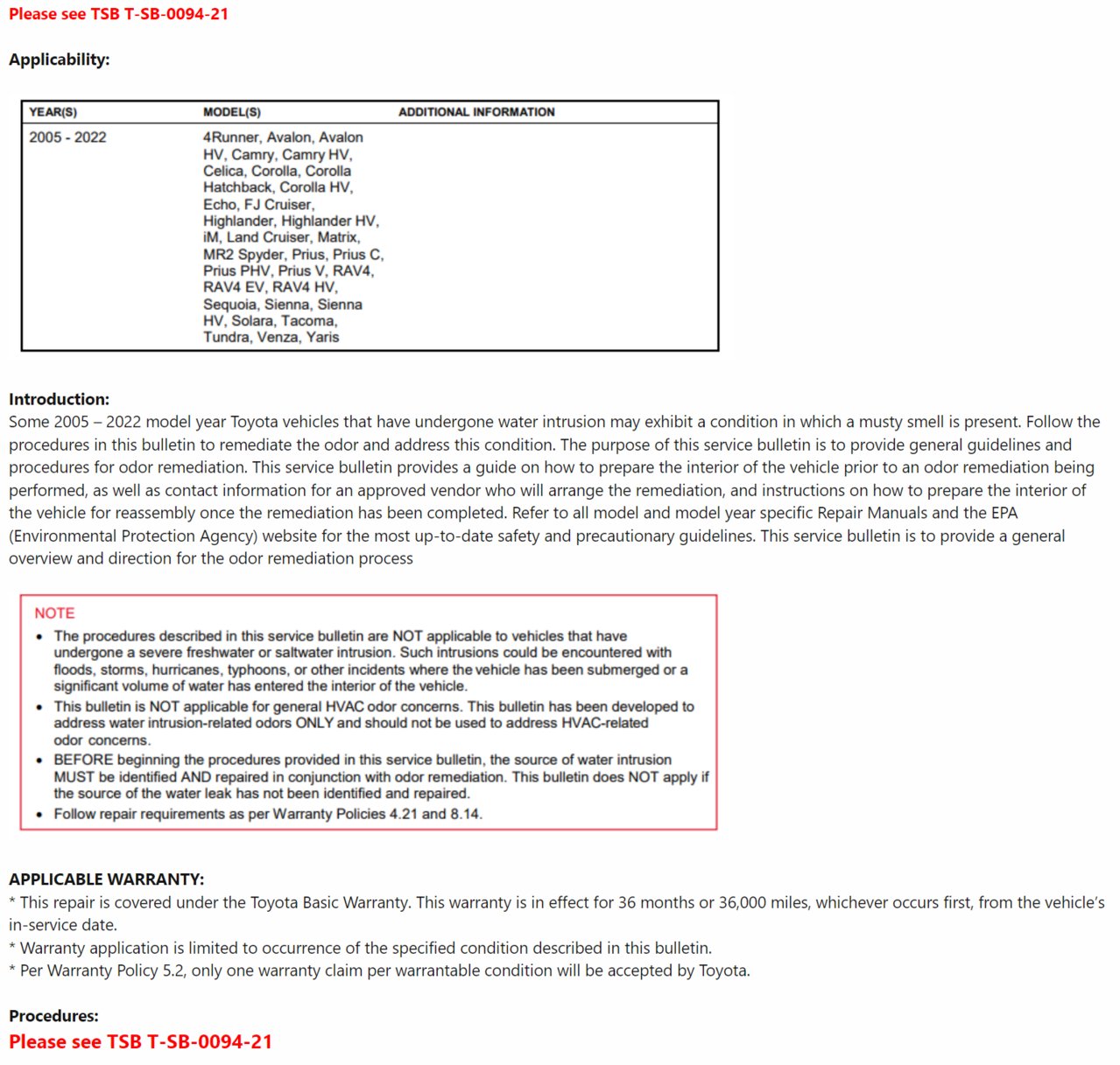

    I found this TSB after some recent winter storms causing excessive water on the road out here in Seattle. I was getting a musty smell in my interior with moisture that looked to be coming through the passenger seat mounts bolts. I hung a Damprid pack behind the passenger seat, and that helped quite a bit. But I was surprised to find this is an actual issue.
    So my questions:
    • Anybody else have this issue?
    • Did anybody actually have the dealership fix anything under this TSB?
      • If they did fix something, what did they fix?
    • Does anybody have any official documentation? This screenshot doesn't supply many details and the link is a dead pdf link. (https://static.nhtsa.gov/odi/tsbs/2021/MC-10204571-9999.pdf)

    well do you have water intrusion or don't you?? pull up the carpet . if there is water underneath you do. and this bulletin may apply. if not this bulletin does not apply... says so in it.
