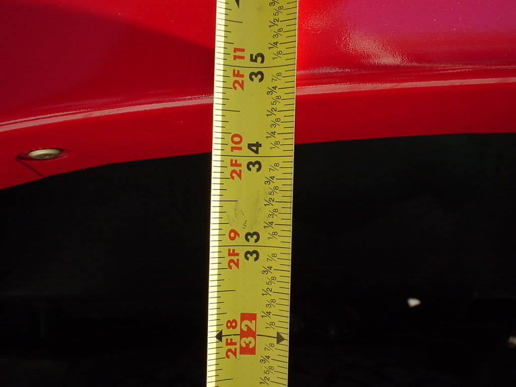

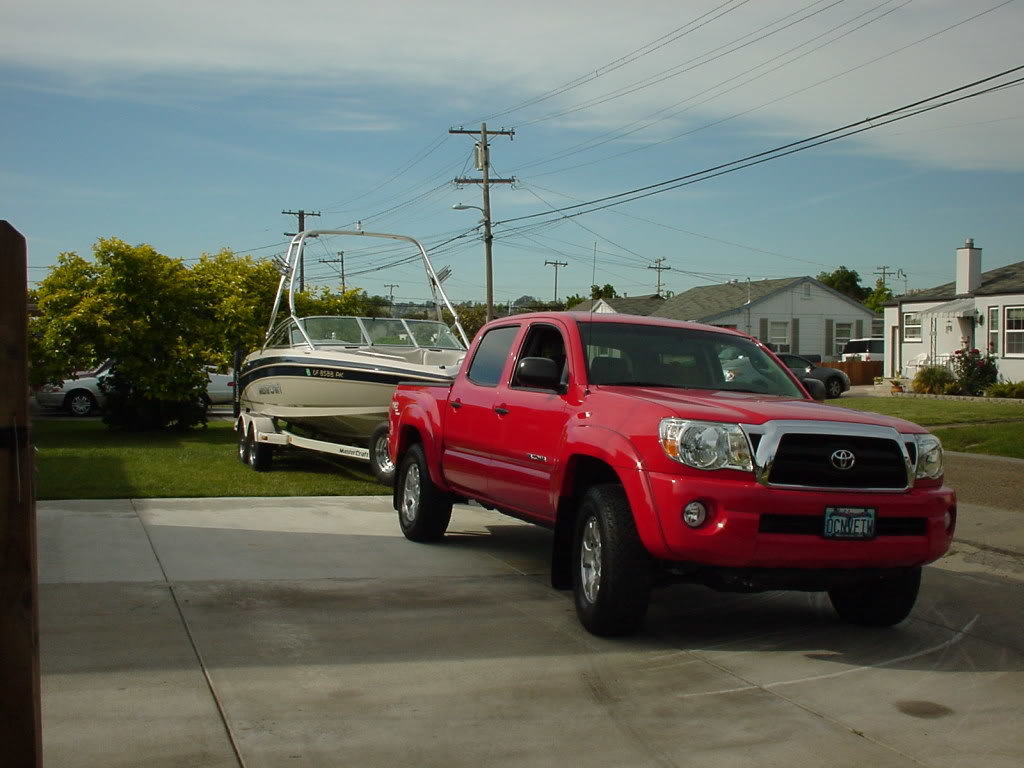

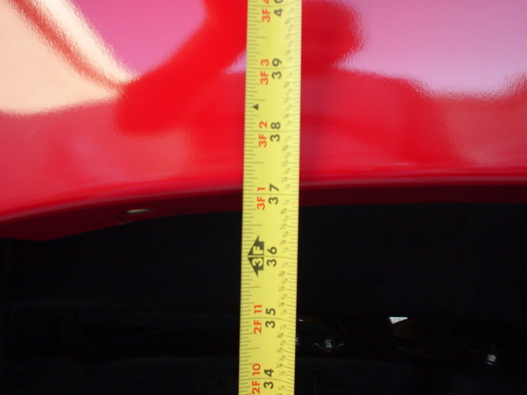

    The Dealer was great. I did the TSB because it was bottoming out with weight in the bed. Plus, I tow a MasterCraft.
    Without any weight, I gained 2 3/8" with the 4 Leaf TSB
    Here's the Pix:
    Before: (Sorry of pic angle it's at 34 5/8")
    :eek:
    After:
    MC: Total weight Loaded, Gas, Stuff 5200lbs.

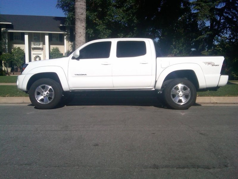

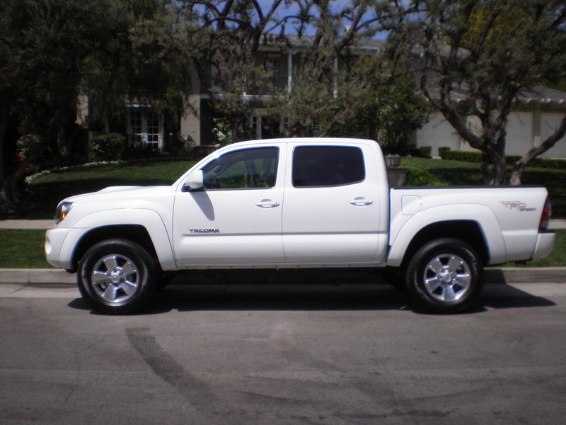

    JUST got mine done today.. diven > 5 miles to where pics were taken. shotty pics but the difference can be seen... pay attention to the rims in relation to the fenders.
    WITHOUT LEAF
    AFTER TSB WARRANTY FREE INSTALLATION..
    you CAN see quite a difference..

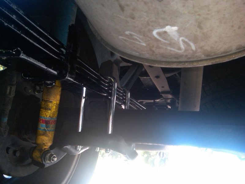

    heres the leaf.
