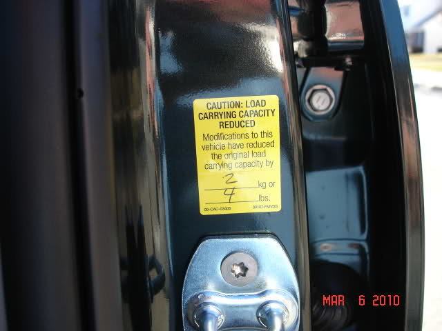

    first photo is of what is currently under the truck - 3 leafs
    Is it correct that the TSB will change the number to 4?
    the 2nd photo is of a yellow sticker on the door post indicating that the capacity has been reduced by 4 pounds
    What is that about?

    Oshnjoe, the answer to your first question is yes.
    Let me assure you from my experience that there is no correlation between the yellow sticker and the TSB which is being discussed in this thread. NONE WHATSOEVER.
    The yellow stickers are a topic for another thread
    The stickers are part of a safety recall. The recall had to do with conforming to a U.S. Federal Vehicle Standard. Toyota used the wrong stickers because of your type of tires/rims Click here to read/discuss the yellow stickers.
