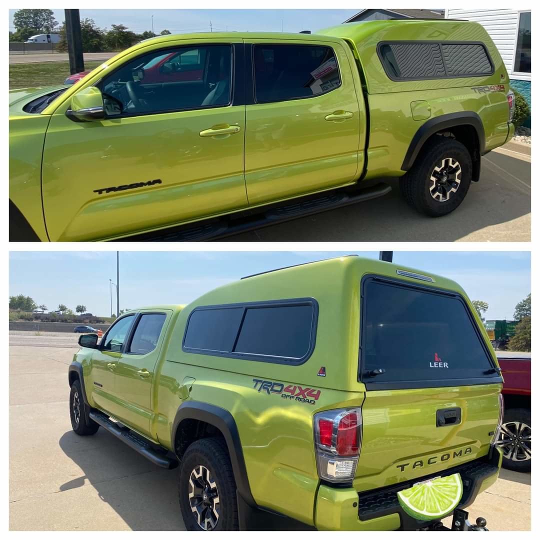

    I know absolutely nothing about my truck....other than, 1- I've always wanted a Taco
    2- I have the weird shifting points and no real throttle response.
    I go in tomorrow for my 5,000 mile service. (2023 TRD 4x4)
    What the hell Exactly am I asking for...A service bulletin
    that encourages dealers to tweak the transmission shift points? Like a computer program update??
    Thanks for keeping it Very simple for me.
