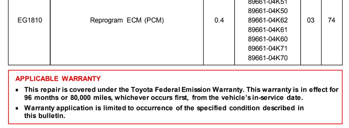

    Yep. As an example from TSB-0058-18:
    Codys9469[QUOTED][OP] likes this.

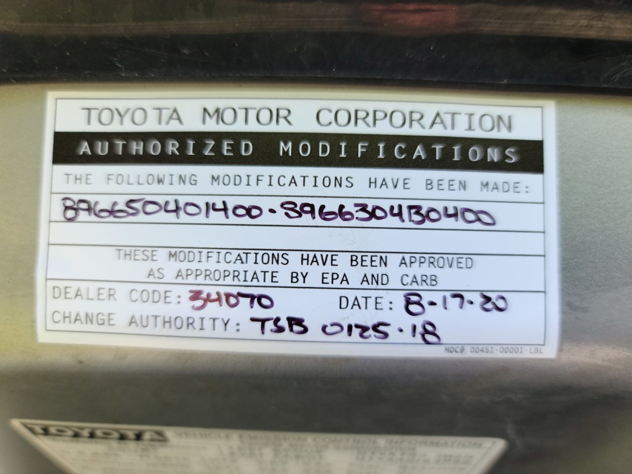

    Cool!
    You're in good shape then, also with some good luck at actually getting the dealer to do it. It has been a struggle for most everyone.
    :cheers:
    In case you need it, your ECU ID is now 04B04, shorthand for 8966304B0400.
    QwickC[QUOTED] likes this.

    Was wondering what this was, now I know. Thanks

    You're welcome!
    Wow. It is even more rare for the folks who got the dealer to flash them to have the sticker installed. Very impressive!
