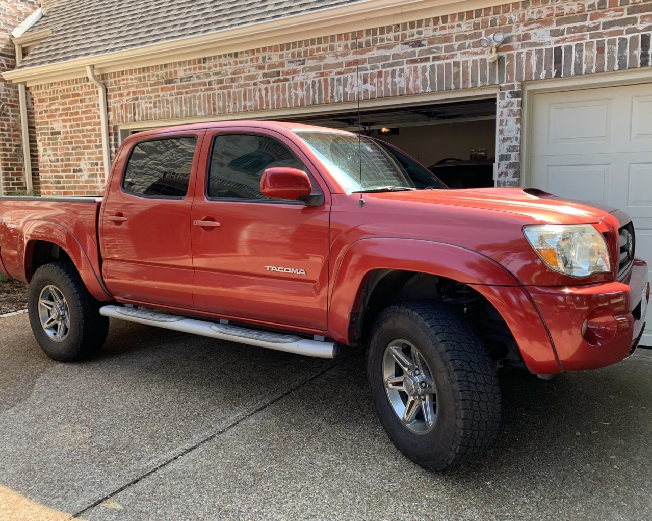

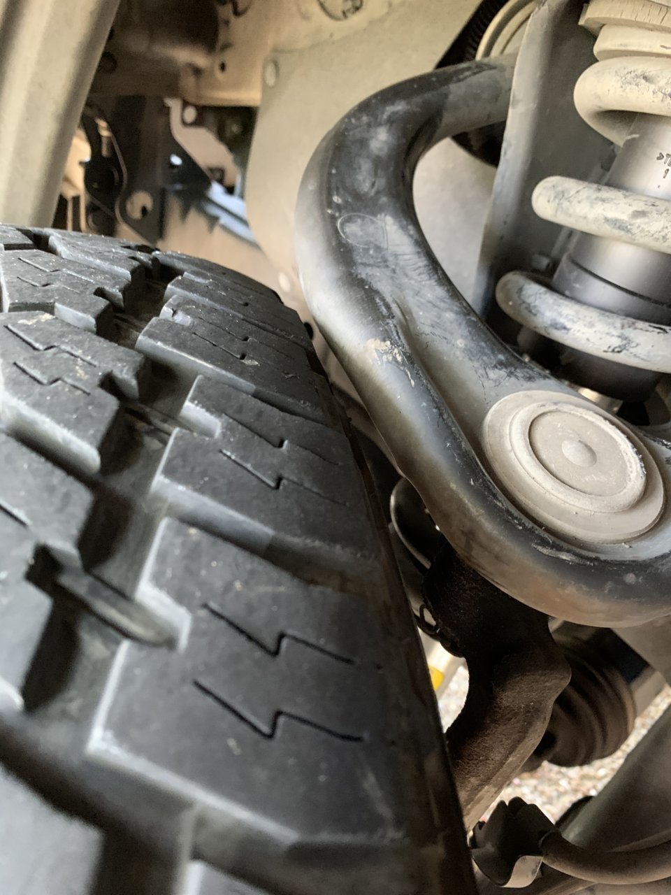

    Thought I would share my experience after lifting 2.5” with 5100, the factory TSS has just enough offset (18) to clear the upper control arm by about 1/3”. Thought I needed spacers, but this will do for now.
    Will be redoing driver side due to 1/2” lean. Should’ve done more research prior, but figure it’s best to get it done right before getting the alignment.

    Is that the clearance with it just on the ground. Once the suspension starts to cycle it’s gonna rub. Definitely closer than I’d like.
