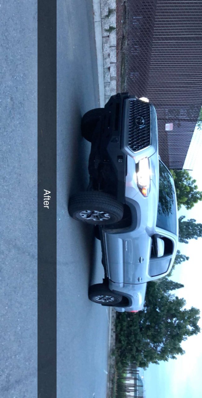

    Sooo I put a bumper on my truck from victory 4x4 and looks amazing. Only problem I’m having is the tss pre collision is malfunctioning and don’t know what to do about it.. need to put a delete kit with it out something??

    Did it myself! No sensors pulled off. Just cut the front bumper

    This is the first time I've ever heard of this issue without the tubing. OP, are you 100% sure you didn't unplug any sensors? I would try and unplug and replug in the radar on the grill.
    If that doesn't fix it, the only thing the bumper would effect is the height of the front of the truck (but pretty slight.) Please keep me updated.

    There is a new recall on the TSS for the 18-19 models, but also check to make sure the tss is plugged in.
