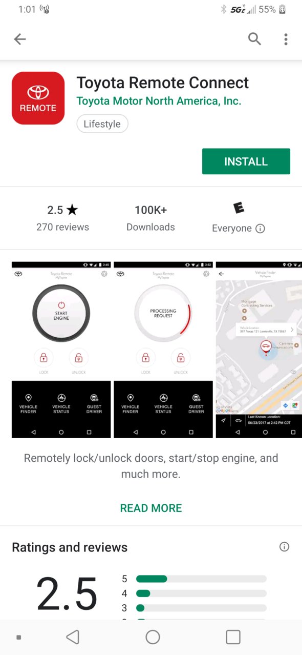

    I thought there was a coding app for Toyota? I know bmw has bimmercode and karly. Could’ve sworn there was one for Toyota

    This guy?
