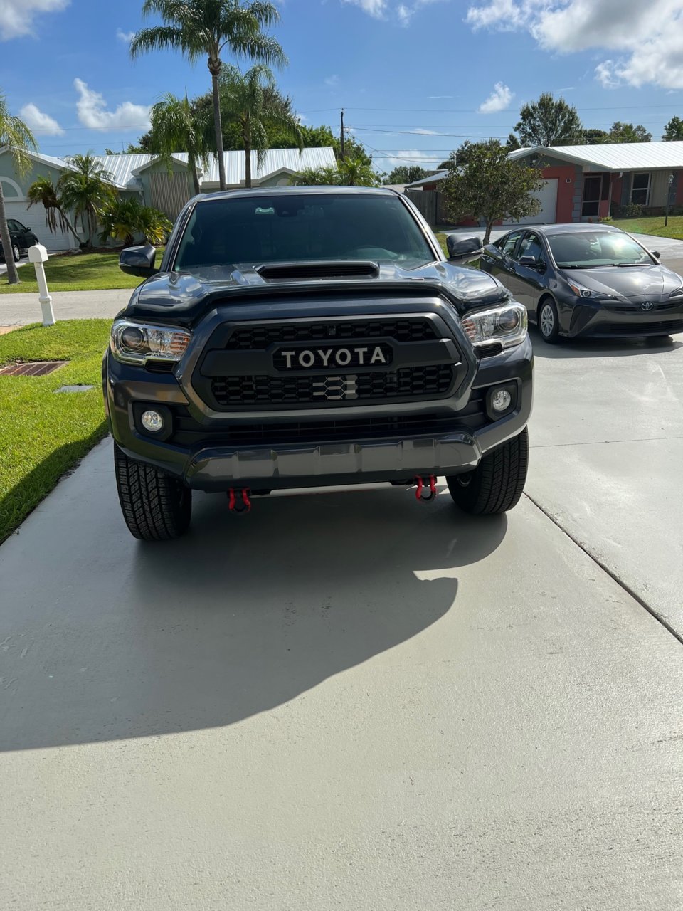

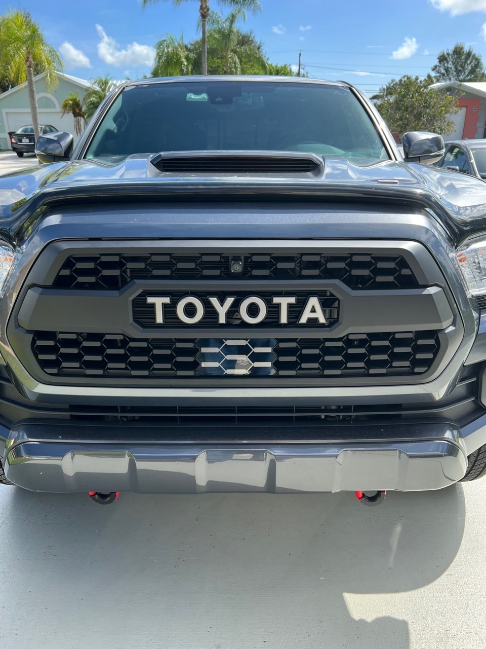

    I got the grille, garnish, and front camera mount all together from Taco Vinyl and am very happy with it. The install was smooth and no TSS error at all. If you order the grille and garnish, the garnish comes already installed with the grille.
