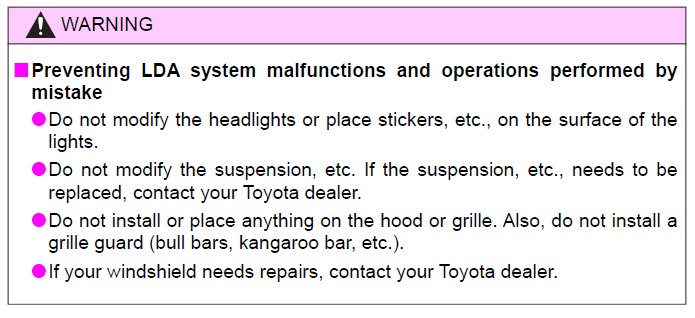

    What error are you getting?
    Is the light bar sticking out where it may interfere with the radar? They mention in the manual that bull bars may interfere.
    If you disconnect the light bar power is there still a problem?
    If you remove the light bar but leave it wired in is there still a problem?
