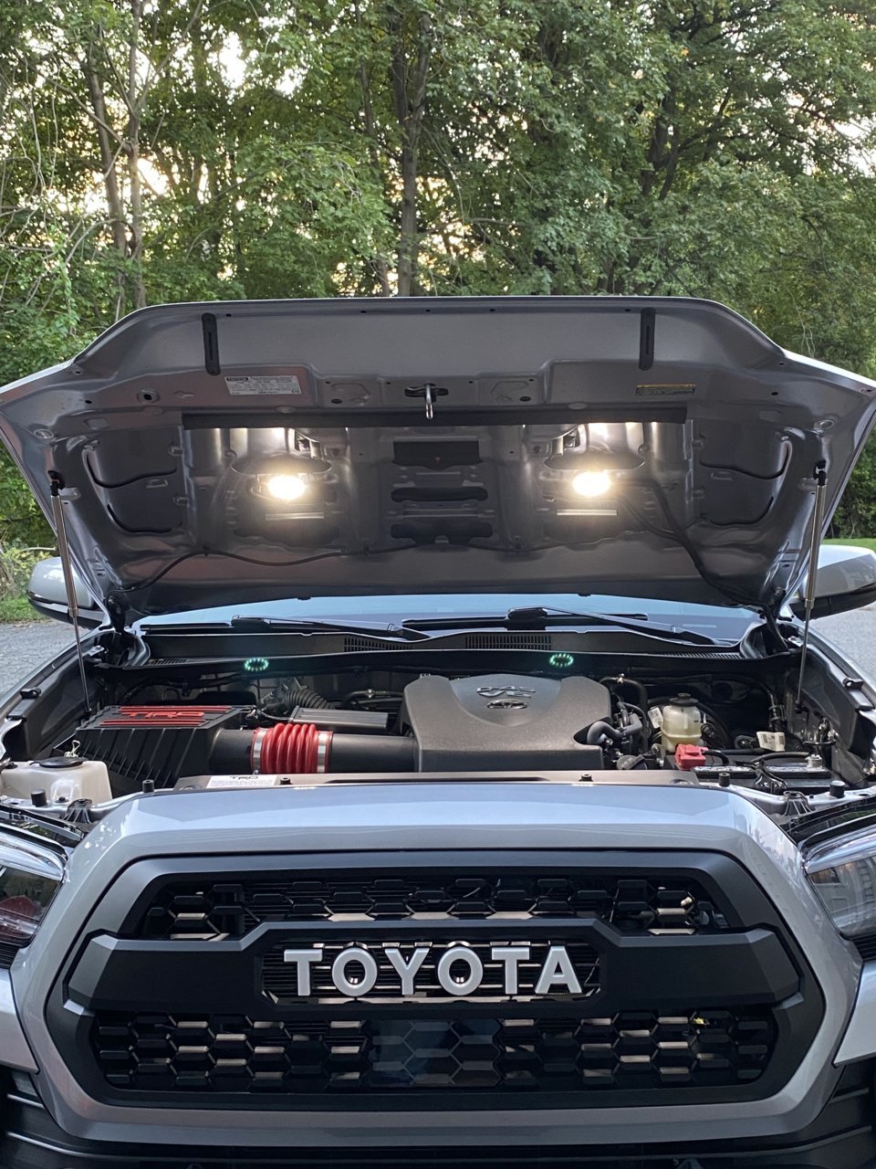

  15. Dec 20, 2021 at 5:01 PM

  18. Dec 20, 2021 at 5:07 PM
    #58
    TacoTime55
    TacoTime55 TT59
    Sep 28, 2021
    #378314
    10,079
    Ed
    Delaware
    2021 Midnight Black TRD Sport AT/DCSB
    TRD Lift,OTT Tune, LED HLs,TRDSkid, TalonCAT
    Gorgeous!
