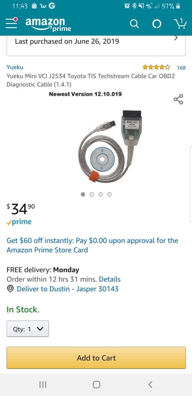

    Hey man I just fixed mine yesterday. I lifted 6 inches and I had collision control lights, abs lights, check engine and traction control lights. Couldn’t use cruise control either. The fix was re calibrating the zero point. This becomes uncalibrated when the steering wheel angle changes after an alignment or one of the he sensors are replaced. Either have a dealership do it or purchase a Techstream cable with software off Amazon and do it yourself. It was super easy to do plus you get extra features you can change or run diagnostics on your truck with it. Worth the 30$

    What cable did you go with

    Thanks!
