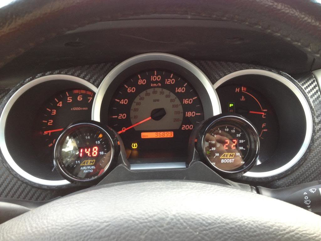

    1) FINALLY got a boost gauge installed! Got this one second hand though so its not brand new!
    So you can see i Tee'd in the boost line of the supercharger and so far the gauge is only reading a peasy 7psi!! WTF should be around 9 at least with the 2.7 pulley!! (Note: Elevation is only at 1200ft)

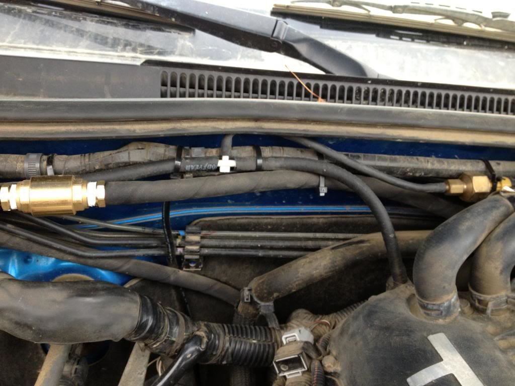

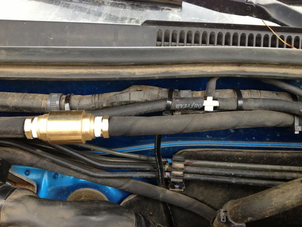

    2)Got the issue of my fuel line always being empty making the engine crank over some more before the fuel lines are pressurized. In line check valve solved that issue!
  11. Sep 30, 2013 at 6:10 AM

    Looks good man. I do find it weird that the check valve on the pump wasn't working, to keep the lines pressurized. Either way, ever the innovator when a problem presents itself.

    Yeah I dunno what's up with that, this check valve is somewhat working -.-'
