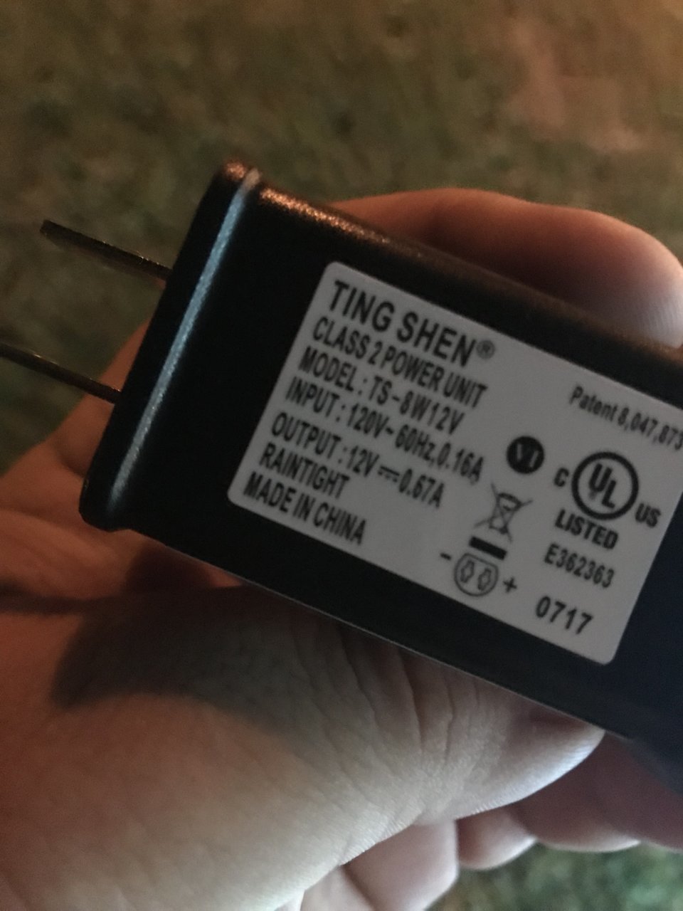

    So I got a question. I don’t know how it works today’s was the first time ever even touching it. The power in the bed of our trucks only has a max out out of 115v right. So if like in this pic it needs a 120v it will not work? And if is what do I need to make it to get to over 115 with out doing a big project? Am I right from this pic that I need 120 to run it?

    You should be good to go. It’s only a 0.16amp draw. That’s dick all. It’s not like you’re trying to power up a Saw or Drill.

    You are good. Internationally, our good old US 120V is 110-130V 60 Hz World wide, with a tolerance to boot. Depending on where the stuff comes from, you will see those variances. (Part of my old job, honest!)

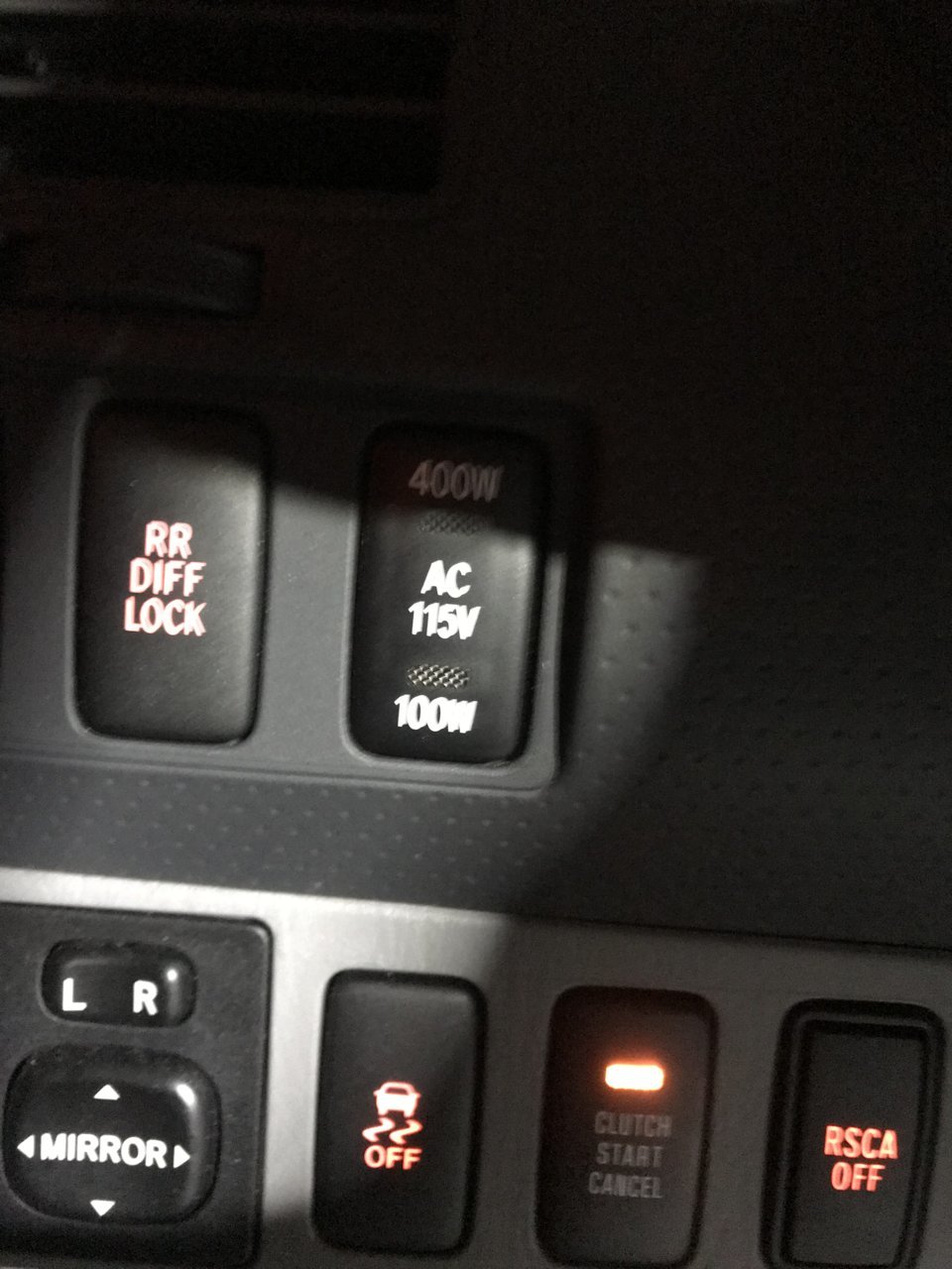

    Ya I plug it in and it doesn’t work. I checked it on the wall and it works fine. The switch lights up when on. So not sure where to go from here then.

    Then it wants a better sine wave. The factory inverter is Not a pure sine wave model, I do believe. Electronic stuff is pretty particular about the quality of power it receives.

    Truck does need to be running for inverter power IIRC. Been a while. And I remember plugging stuff in and WTF?

    I’m not too good at explaining this but A/C is just that. Alternating current. You want smooth alternation. Non pure sine wave inverters aren’t capable of producing it. If you look at the price of a pure sine wave inverter, it’s like double for half the power. But the power is clean. Smooth, not choppy alternation. There’s a thread that explains this waaaay better than me.
