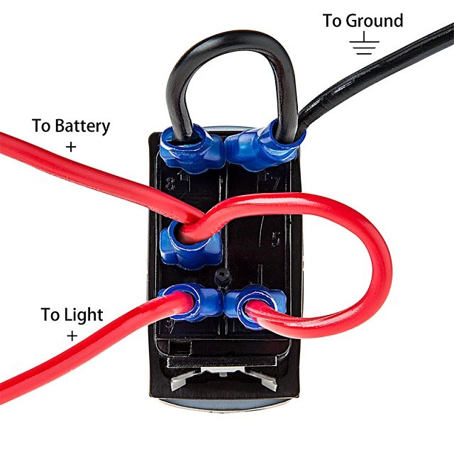

    Anybody in here REALLY good at wiring and can explain something to me like a 5yr old? Wiring is my krypronite and I’m trying to get better. I got all my switches to work but kinda confused as to the lights on the back. I can PM you a diagram of what I did. It’s on 5 pin switches.

    I'm purdy good although it is early and I didn't sleep at a Holiday Inn Express last night. Most 5 pin toggles have 2 pins that are used to illuminate the switch. The other 3 are for ground, + and output to the source (light).switch.jpg

    Which one goes to the accessory then if the power one goes to both pins? Like on that pic it looks like power goes in but never comes out ? Or am I just looking at it wrong

    Ohhhhh the output light one is the accessory one. Fucking gotcha. That helps a ton

    I wish all diagrams can in color and picture like that. Would help so much.

    If I have 3 switches, can I just jump the ground to all of em like pictured off the one ground wire?

    Yes, just make sure you are tying it all back to a good ground.

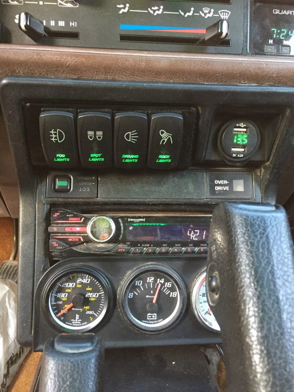

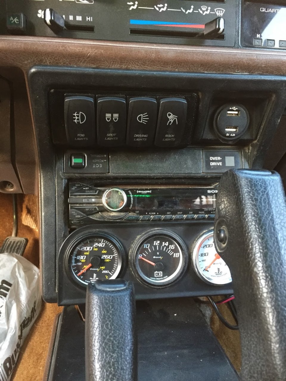

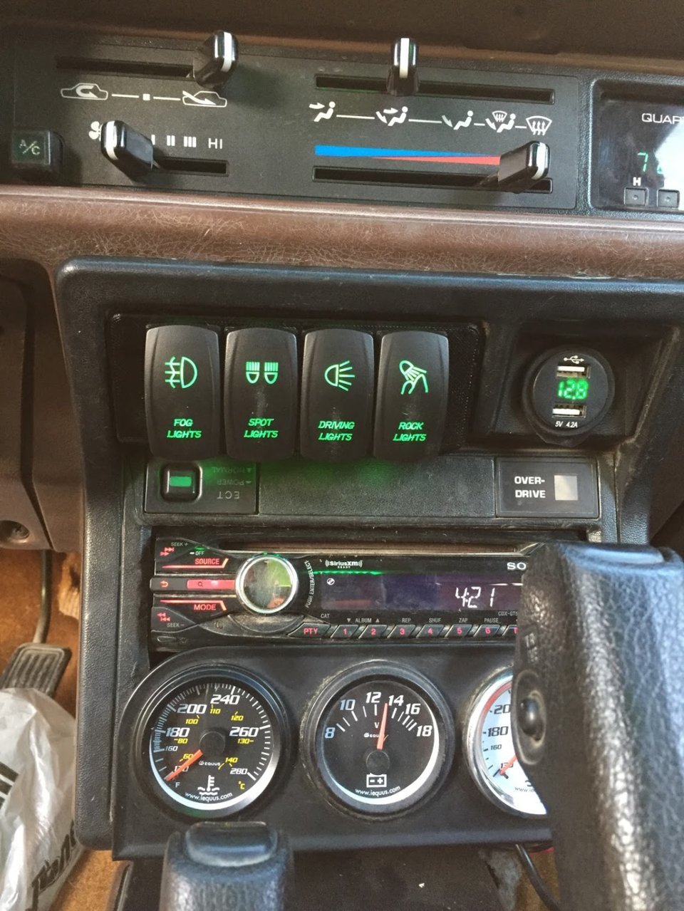

    Yes, all grounds can be jumped together.1.jpg 2.jpg 3.jpg Here are the 3 states: Off, power On, and switch turned ON.

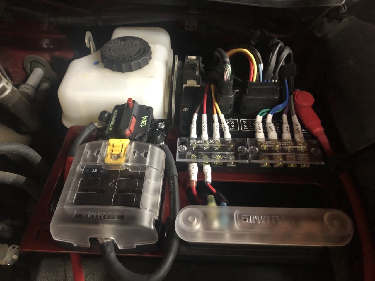

    This is what I did for my wiring but I’m also running the switch pro

    One thing to be mindful of is where you are getting the +12v from. 3 of my switches are set to only work when the key is ON. The rock lights however can be left On with the key Off. The difference is between using ignition power or battery power.
    I also have all 4 outputs from my switches to a relay box. The switches actually just power the relay and then the relay takes direct battery power to the lights.
