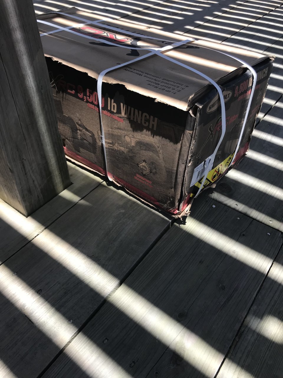

    Hell ya I won a winch at that Tacoma Beach party. Over 60 trucks.
