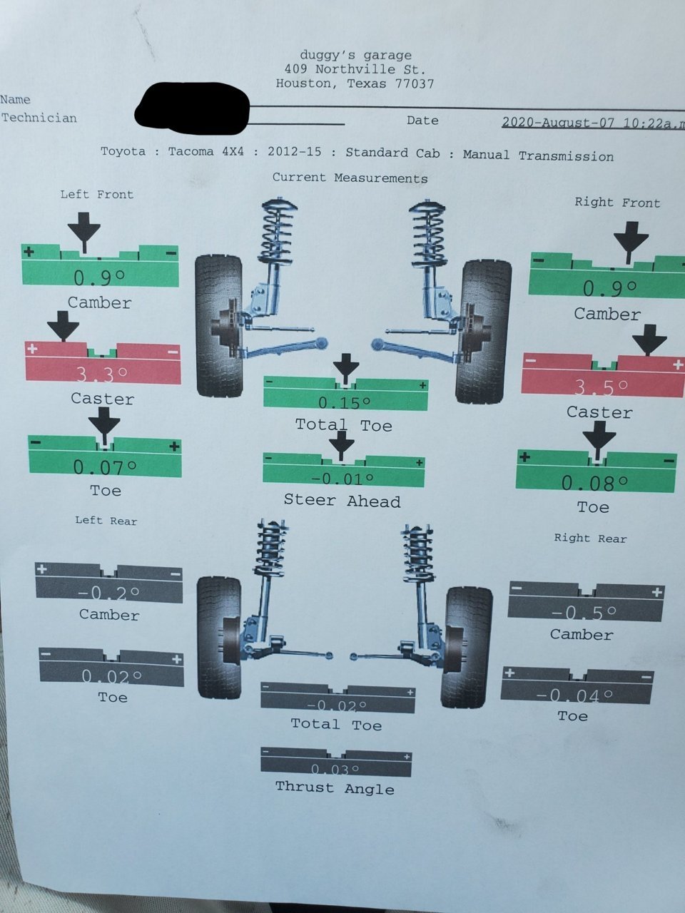

    Ive got a question for you fine people, I just got an alignment on my truck after installing all of my lift stuff and it now wanders and cant seem to hold a straight line, very noticeable on the highway. I'm hoping someone here can tell me what the problem might be.
    2015 DCSB Cooper STT MAXX 255/85/16 @40PSI for now, testing different pressures for how they affect handling
    Fox 2.5 CO W/Resi cranked up to the 2.5-3" max recommended lift, SPC UCA
    Allpro Expedition rear leaves w/ Icon 2.0, 3" lift

    Since you have a truck, any weight in the rear? If nothing significant, drop the rear tire pressure 3 to 5 #'s less than front. Next, I think 40 is too much for those tires, try 36 front and 33 rear. Alignment numbers look fine.

    no weight in the rear, I’ll be picking up a yard of mulch today tho so I’ll report how it feels with a couple hundred in the back and I’ll try the new pressures
