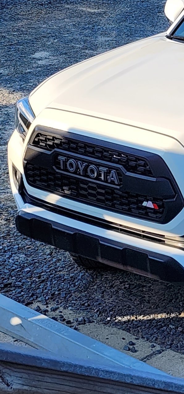

    I had the same thing happen to me today, I just bought the truck on Friday 7/22/23. It's a 2020 TRD off road and previous owner put the TRD pro grill on it. So today I was driving around 60mph no one Infront of me and I had the cruise control on, and then all of a sudden it went off and gave me an error message "radar cruise control on available clean sensor" here are some images of the truck from the front so you can see the grill that's on there, it went away when I turn the truck off and then on again and seem to be working properly the rest of the afternoon. Since I just bought the truck Friday I was right by the dealership and I swung in to let them know what was going on obviously they didn't know anything because it was a Chevrolet dealership that I purchased a truck from so I'm reaching out to you guys to see what I should do if anything, not quite sure how to align the sensor correctly. Another user mentioned that the sensor would just recalibrate itself. Kind of at a loss right now.

    I went through this on my aftermarket grille.
    From what I can tell, there are a number of variables. Most obvious is sensor positioning, which can really only be solved by recalibration (screw that, that costs money) or trial and error adjustment. Try to get it as square and perpendicular as you can. It's not super-duper sensitive to positioning, but sometimes small adjustments will get it back into its preferred field of view.
    The other variable that I discovered the hard way, is that garnishes/shields can have flaws. Sometimes there's a speck of dust trapped between a decal and the garnish :anonymous::anonymous::anonymous: or sometimes its a flaw within the plastic itself. Either way, the sensor sees dust and/or air bubbles as a big patch of mud in its figurative eye, and reports an error. If, after a month or two of playing the positional trial and error game it still gives errors, try replacing the garnish. It just might fix it.

    I have the same truck. I replaced our grill with an OE Toyota Trail Edition grill (same as the Pro grill, but with bronze lettering), however I wasn't going to pay the crazy price for Toyota's TSS garnish so based on various reviews here and elsewhere I bought this from Taco Garage. After I installed everything I also encountered a similar message, something about the connection - sorry can't recall exactly what it was. So I disconnected the two plugs (one on the TSS sensor itself and one clipped to the grill), sprayed the ends of the wiring and the connector contacts with CRC Contact Cleaner and securely plugged it all back in. Everything has been working perfectly since.
    Not sure if that's the issue or not but you could give that a try. Afterward I'd try turning cruise control on and off a few times on a few different trips. I've also read that it can right itself. Or as as @Rock Lobster mentioned it could be the garnish too (easy to replace). Or it could be the sensor itself. Used ones pop up on Craigslist and FBMP now and then.
    I've seen posts/stories about folks using washers and what-not to try and realign the TSS sensor, aiming it higher or lower or whatever. If it was working previously and then it stopped working, the alignment is probably good IMHO.
