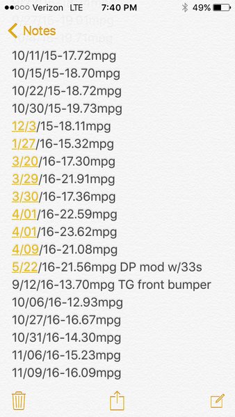

    Great info! So you had stock bumper when you changed tires and you saw loss in mpg but once changed bumpers there was no noticeable difference?

    I watch mileage pretty close as a hobby. stock I got 15 city and 19-20 highway.
    The addition of a relentless fab front and rear bumper changed that so now I get 16.5 around town and 16.5 on the highway. They have only been on for a dozen tanks of gas but the mileage has quite repeatable.
    I suspect the highway mpg can be improved by (finishing the bumper install) trimming the fender wells that show, moving the windshield washer reservoir, and adding trim pieces to join bumper to remaining fender well.

    Yeah I totally understand. I know it all comes with a price and having a prerunner I would never modify it as much as I would a 4x.
    Just if someone said after getting their tube bumper they lost 5 mpgs, then I could say it's not viable for me at the moment to do this to my DD but maybe someday when I don't drive it as much I can. Nice to know multiple angles about something before throwin a lot of cash around

    The time span between 33s and tg front bumper is huge so take this with a grain of salt, I don't record mpg religiously but the 33s with bumper was a huuuuge killer
