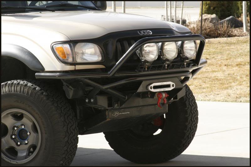

    I've never liked those wheels, but they sure look good blacked out on your truck.
    Here is my bumper built by Landcruiser NW

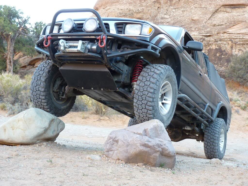

    Toytec 16" coilovers with Tundra Bilstein 5100s, Light Racing UCAs, Alcan Leafs with Orbit Eyes, 12" Bilstein 7100 short Bodies, ARB rear locker, 33x12.5 Duratracs, CBI sliders, Bushwacker fender flares, self made front bumper, M8000, Vision X 6.7" Hi/Lo Beam HIDs, full skids, Inchworm dual case setup - 15º clocking

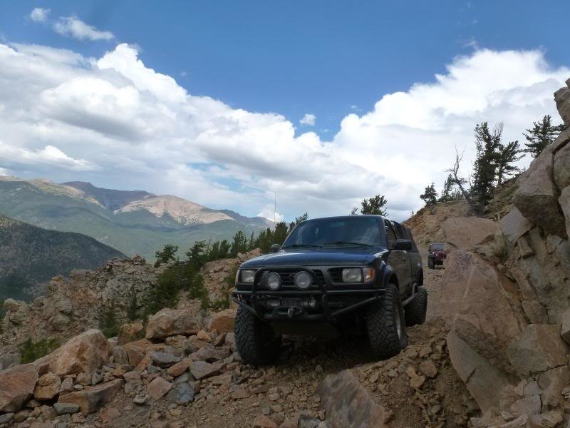

    For those of you interested in my bumper, here are a couple more shots and angles. Feel free to PM me more questions if you get them.
    Front:
    Side:
    You can see how it ties into my skids here:

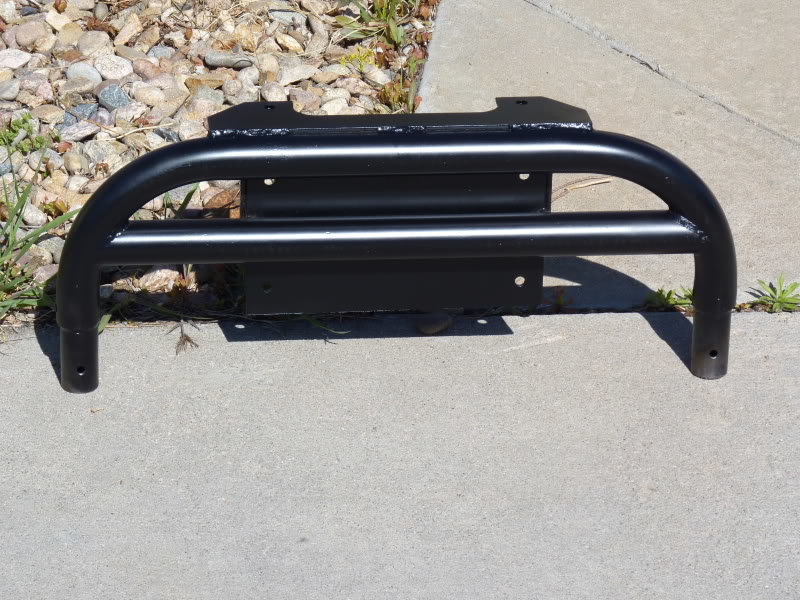

    Here's the relocatable winch plate without the winch on it:
    And the bumper off the truck:
    Random Pic:

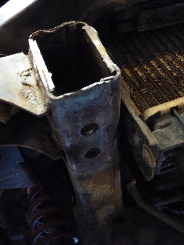

    Hey Timmy,

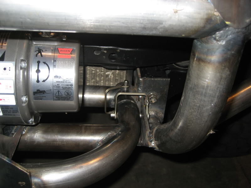

    So, the bumper is bolted to the frame in 6 places. You can kind of see them here:
    and here:
    I've got a bunch more pictures on the first page of my build thread but, basically, I use the two vertical tubes to tie to the frame. 4 bolts are tied through a flat sleeved interface below the vertical tubes and 2 are tied via plate that semi boxes the frame in front.
