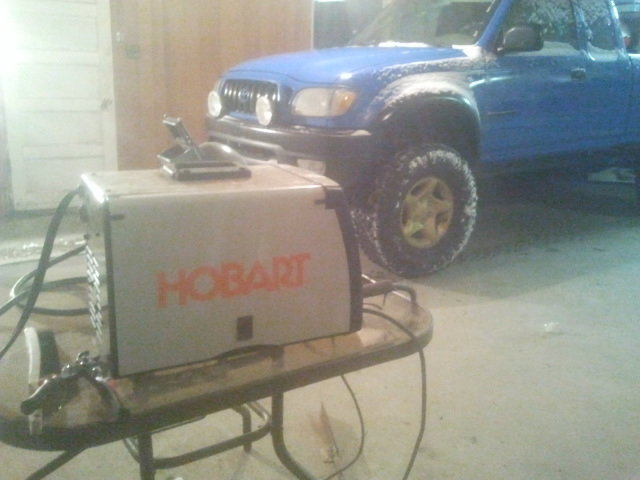

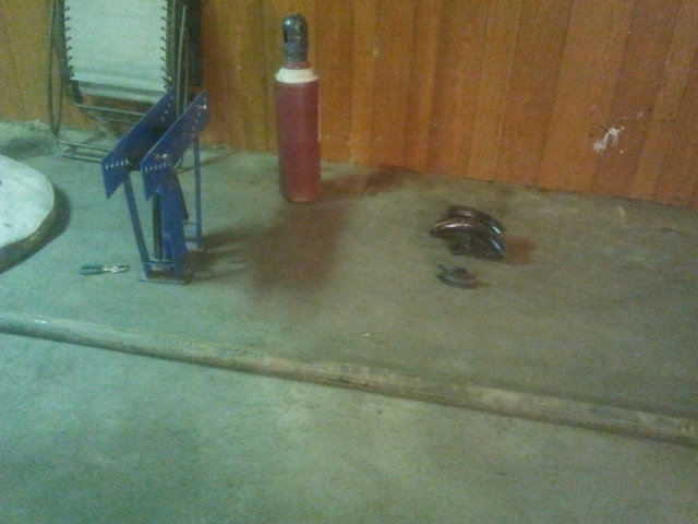

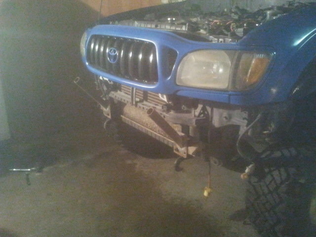

    So i went to the scrap yard and got some 2.5" & 1.5" schedule 40,Borrowed my dads mig and pipe bender then got busy.
    I like the prerunner style bumpers, But i want a little extra protection on the sides.

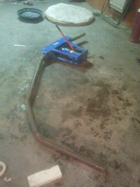

    Started doing some bending, Easier then you imagine!
    Having never used a mig before WOW what a difference from the shitty arc welder i have.....Tacked in place before i notched them, used some flat steel from the body lift bumper brackets.

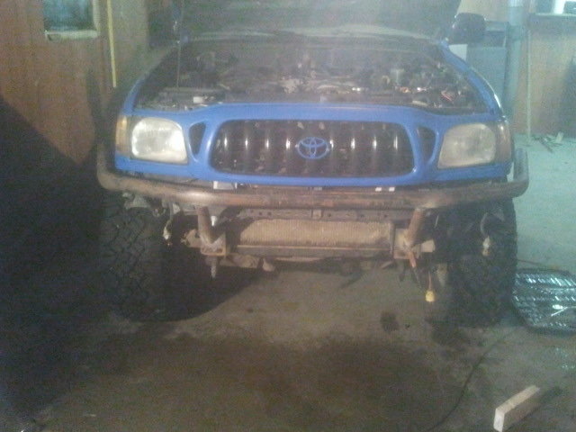

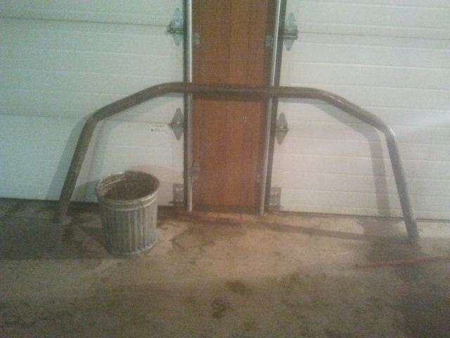

    main tube all bent. gotta cut the ends off after i tack it!

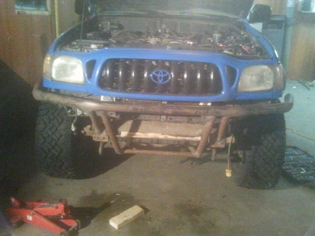

    All tacked in place
    Thats it for tonite!

    Its hard to see from the pics, but are the plates bolted to the frame or welded?
  10. Nov 5, 2013 at 12:17 PM
    specialized7
    specialized7 [OP] Well-Known Member
    Apr 4, 2012
    #76298
    409
    ,Saskatoon, Canada
    05 v6 4x4
    Its 100% bolt on.

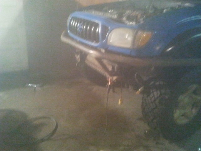

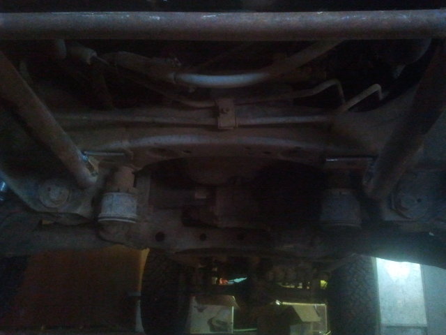

    Mocked up the skid...
    mounts to crossmember

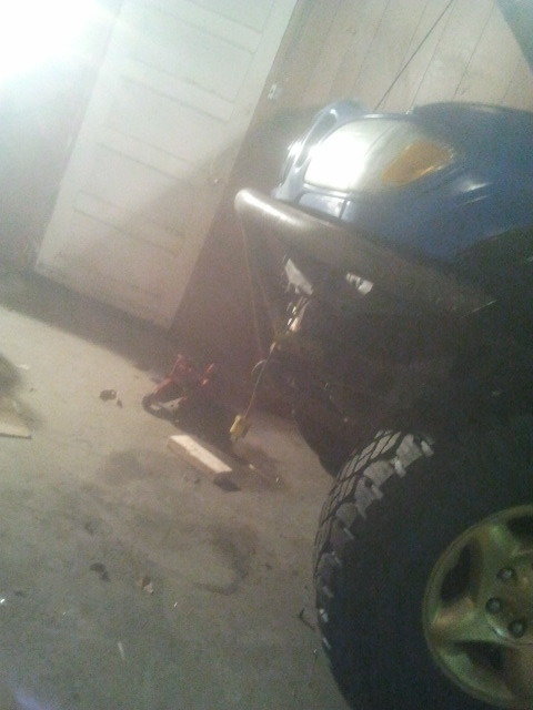

    05 v6 4x4
    Still need to do a light hoop and the peices that bolt from the frame to the outside corners
    once all welding is complete i will paint it with duplicolor bedliner then clearcoat with eastwood urethane clearcoat
