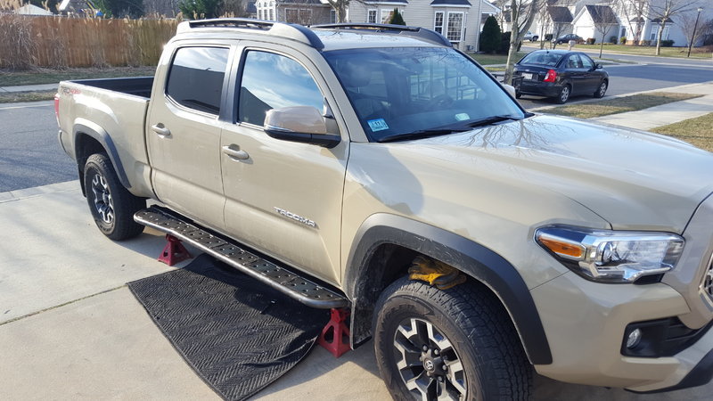

    Here's the pick of mine when I went down to Maryland to pick up my sliders from Mobtown. We test fit them only so I could get them painted up. Don't have any pictures of the finished product yet.
    Edit: I asked for them to be built flat to be easier to use as steps. They typically come angled up towards the body to provide more ground clearance.
