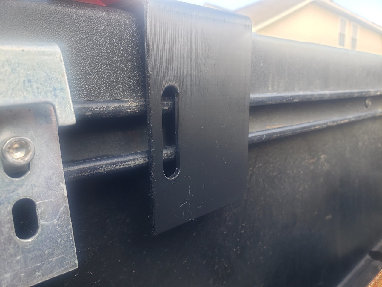

    Several months later I bought a 3d printer for other projects, and I had learned a bit more CAD and 3d modeling, and discovered how design the bracket using the sheet metal tools.
    This time, I was going to be smart about it, after designing version 2 of the bed brackets, I 3d printed a portion of the bracket to confirm fit.
    Still, needs to be tweaked a bit, and perfect example of how 3d Printing saved me money on the final part by finding the design flaw before ordering a second set of parts.

    after adjusting the location of the slots in the design, I had a design that could be sent off to the laser cutter, again.
    Once the new parts arrived, I was able to bend them in my shop using the new finger brake for the 20 ton press I had picked up earlier in the year.
    Once again the 3d printer and the ability to create a prototypes to confirm the design has proven to be a highly valuable addition.

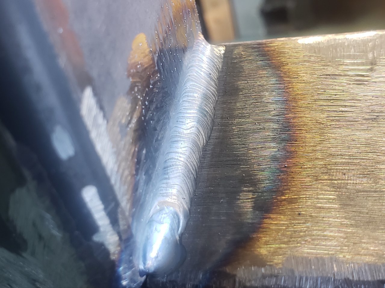

    Building the stand gave me time to practice my welding, Prior to this it had been over 20 years since I did any welding.
    Not weld porn worthy, but I am pleased with them, after only a couple hours of practice, AND teaching myself TIG at the same time. all previous welding had been stick.

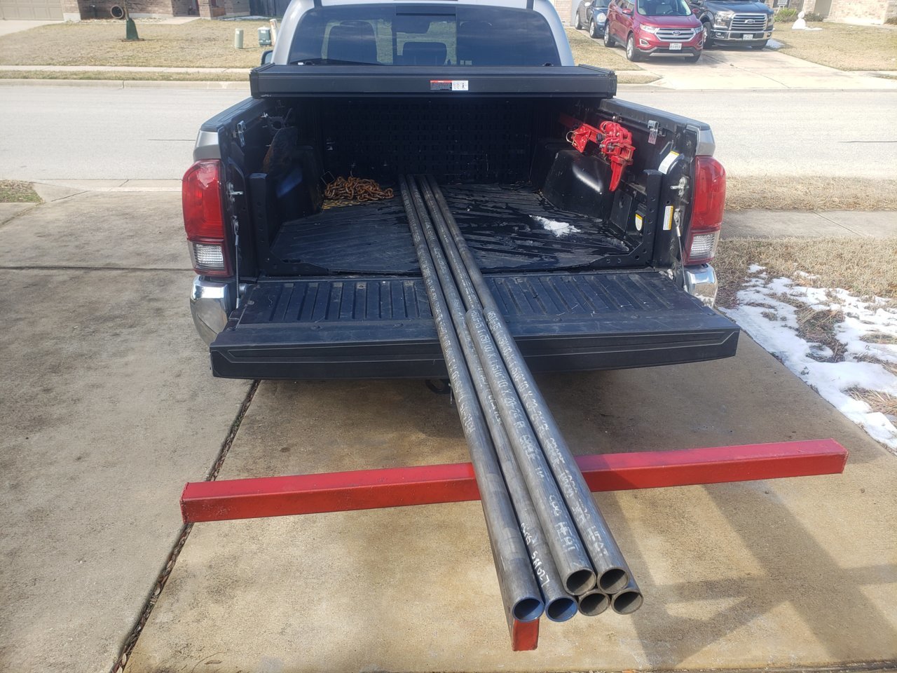

    It was finally time to buy some tube.. When I called the local steel yard to check prices on 1.75" HREW tube, they informed me they did not have it in stock, and would have to order it. So out of curiosity I asked if they had it in DOM. turns out it was in stock at another warehouse a few hours away, and they could get it to me the next day. and I could get get it at the previous price, before the new pricing took effect on the in coming shipment . I was able to pick up the DOM tube for nearly the same price as what the special order for the HREW would have been. So i decided the bed rack was getting an upgrade, and I ordered 2 sticks
    Layout and bending tube was a completely new skill set for me, I had watch some youtube videos and read what I could about it. I took one of the short drop pieces and created a "cheater tube" of the same angle the final bars would be, and I used that to layout a full size template using chalk on the garage floor. I layed everything out, took some notes on everything. then I walked away for the night.
    the next day I went back out, and did the process all over again, and I doubled checked my numbers, and went over it all again in my head, and I again went back to the truck and re-verfied all my measurements, and compared to what I had layed out for the bends. after i was satisfied, I cut the tube to needed length, and placed it in the bender.

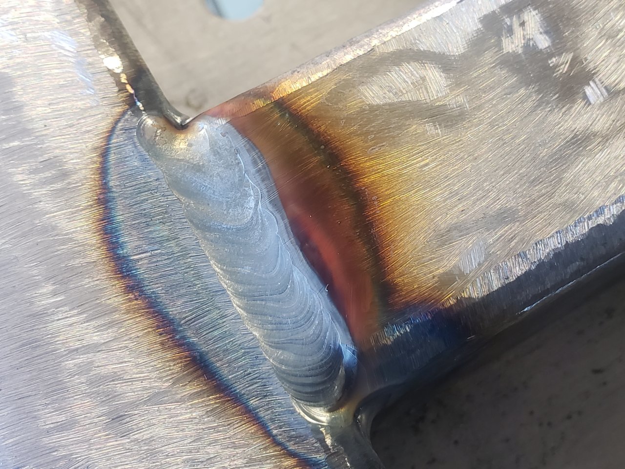

    once everything was tacked in place it was time to weld out the bars. Creative work positioning once again came into play.
    Not the prettiest weld out there... but I know it is strong, and will work for my needs.

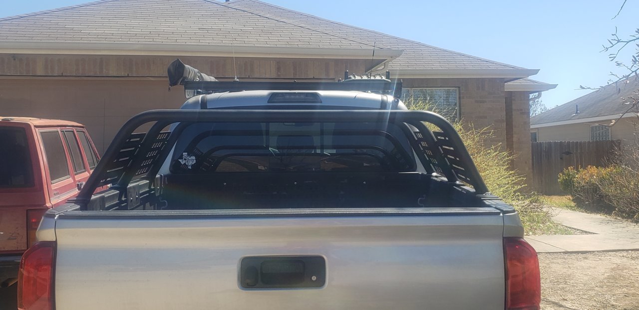

    After painting, it was time to reinstall the bed bars.

    Can't forget the reason for the bed rack...
