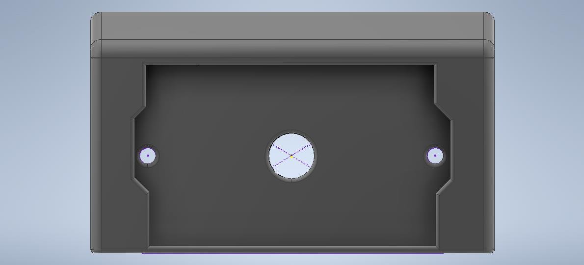

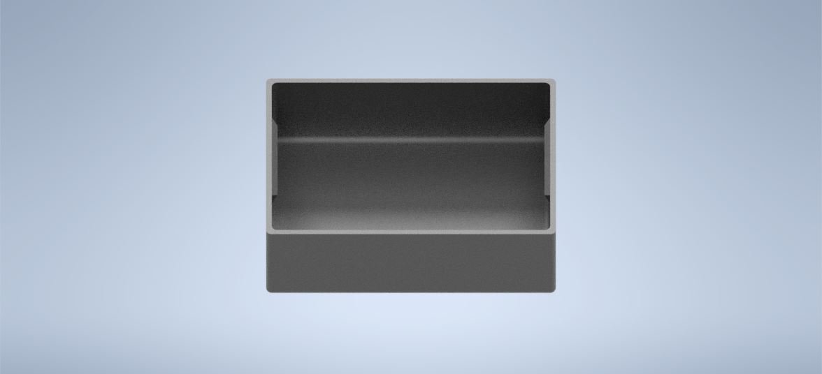

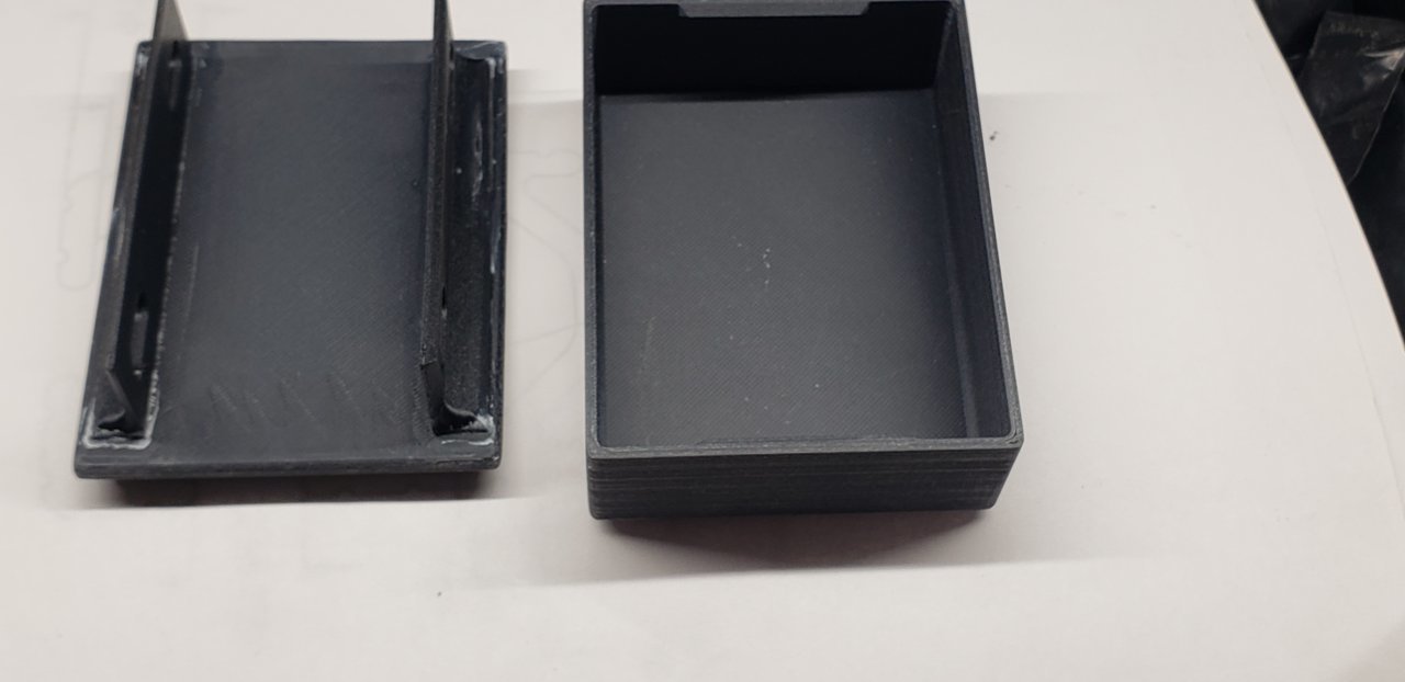

    I was working on a custom mount for some RGBW rock lights for my roof rack, and felt pretty good when @MESO himself gave a thumbs up to the design. I ended up going back to the mount and light the rack was designed for. HOWEVER, I still kept the bluetooth control system I worked out for it.
    The Enclosure for the Relay Module
    Printed in carbon fiber Nylon.
    The Intended mounting location
    Proof of concept video.
    Testing the driver side lights

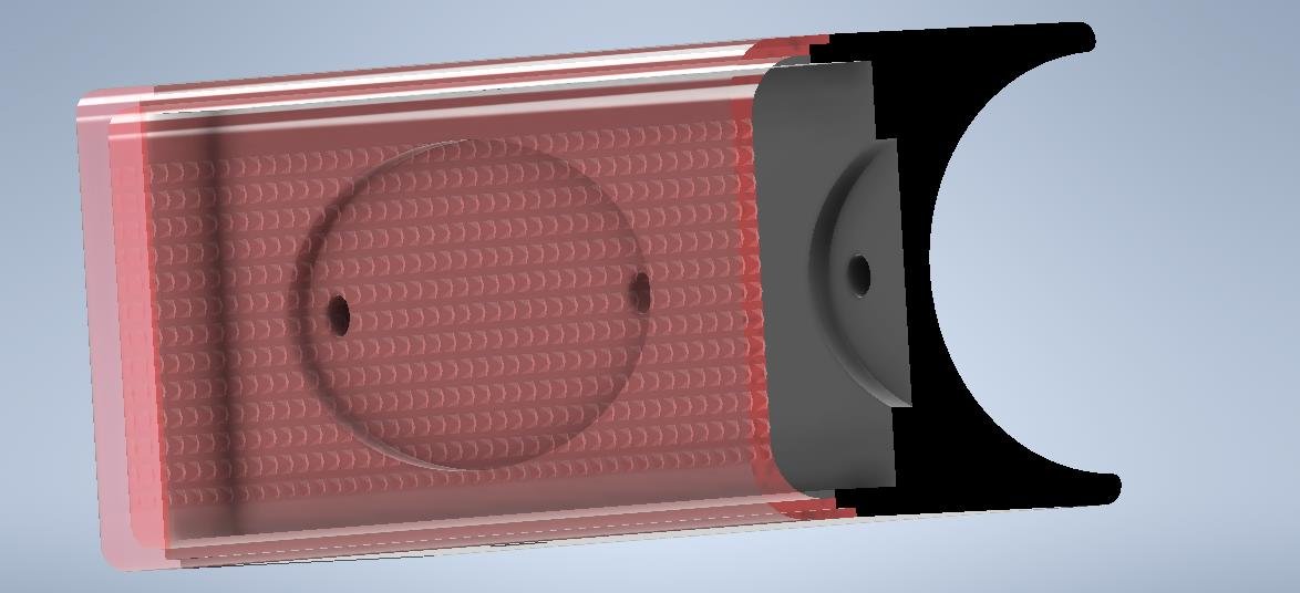

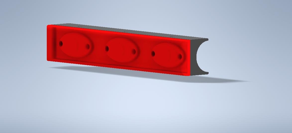

    Ok refined the design a bit.

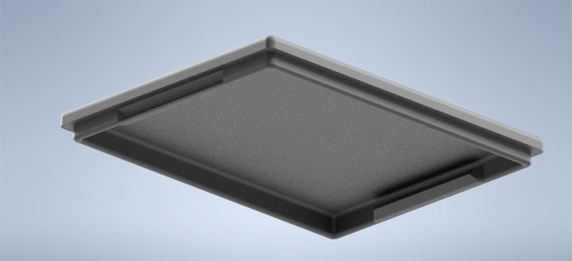

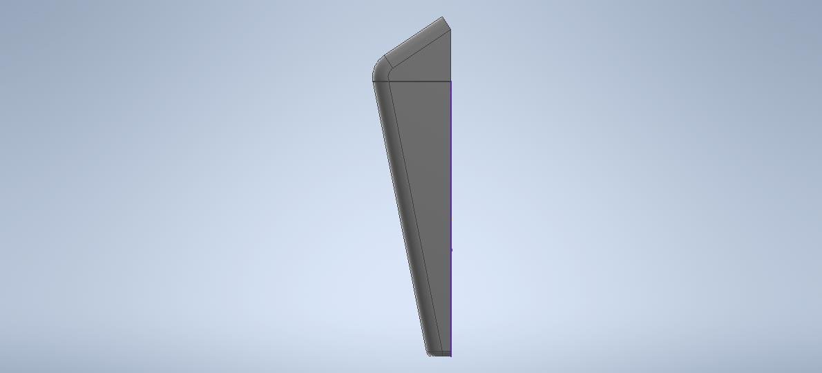

    the lens has the diffusion "pyramids".
    Gunshot-6A likes this.

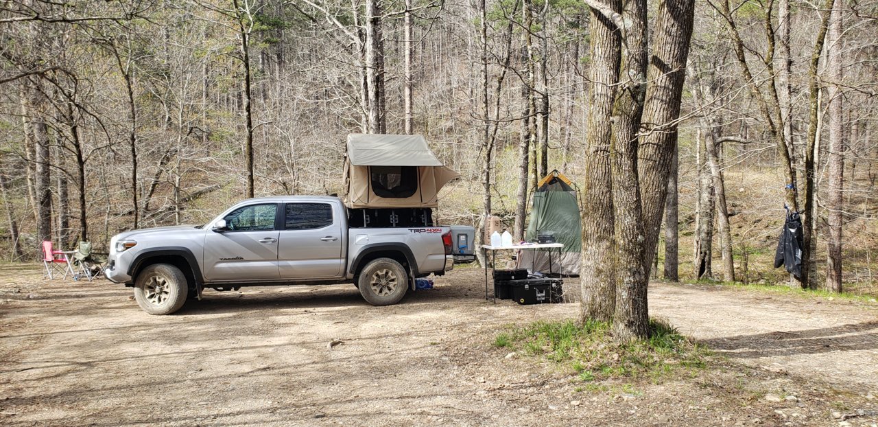

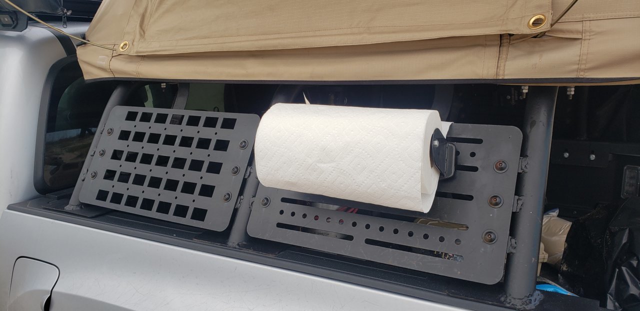

    I recently picked up a magnetic paper towel holder for the toolbox. After opening it up and seeing how well it work. I knew I had found a solution to keeping paper towels handy while camping.

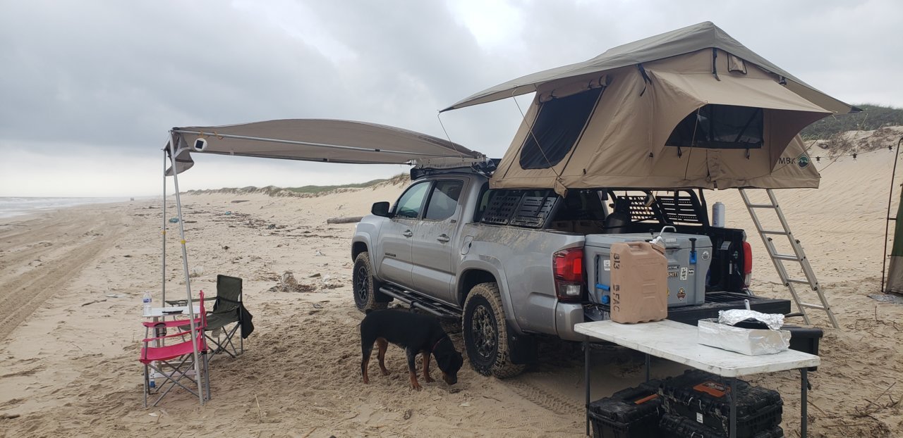

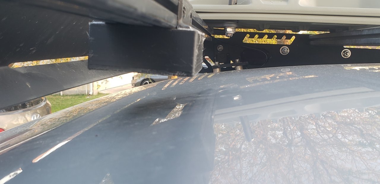

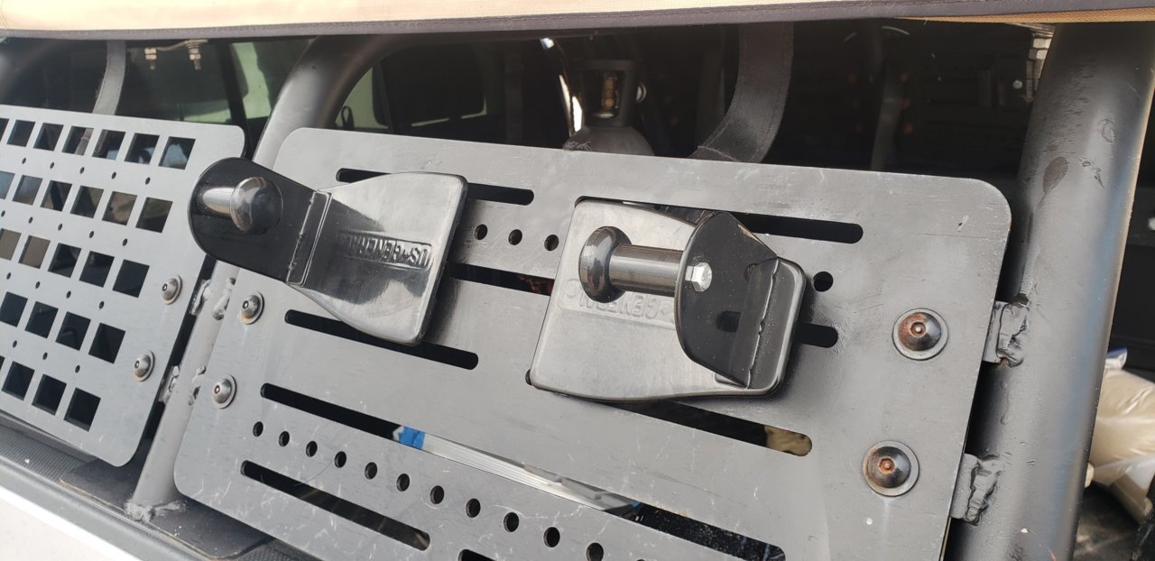

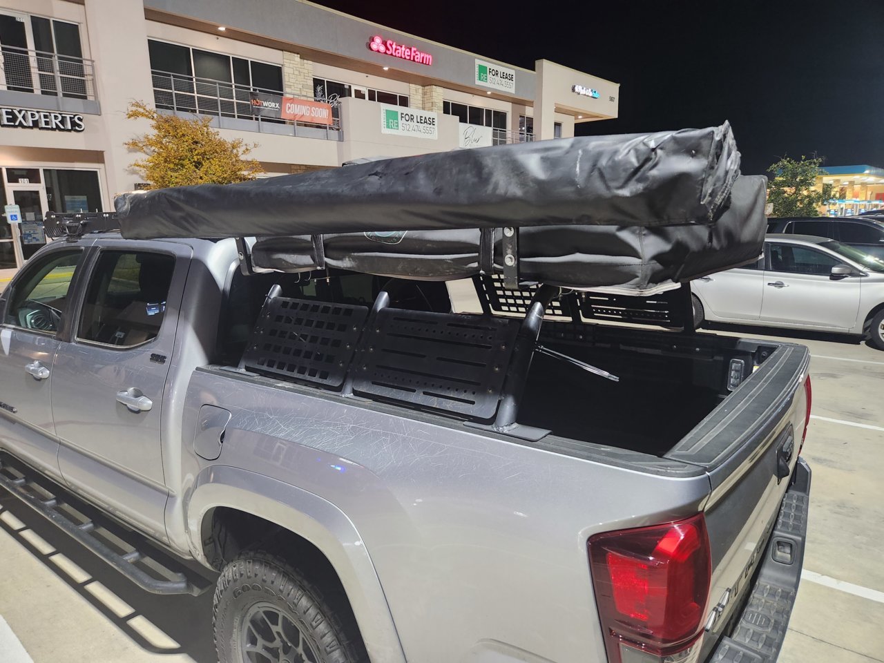

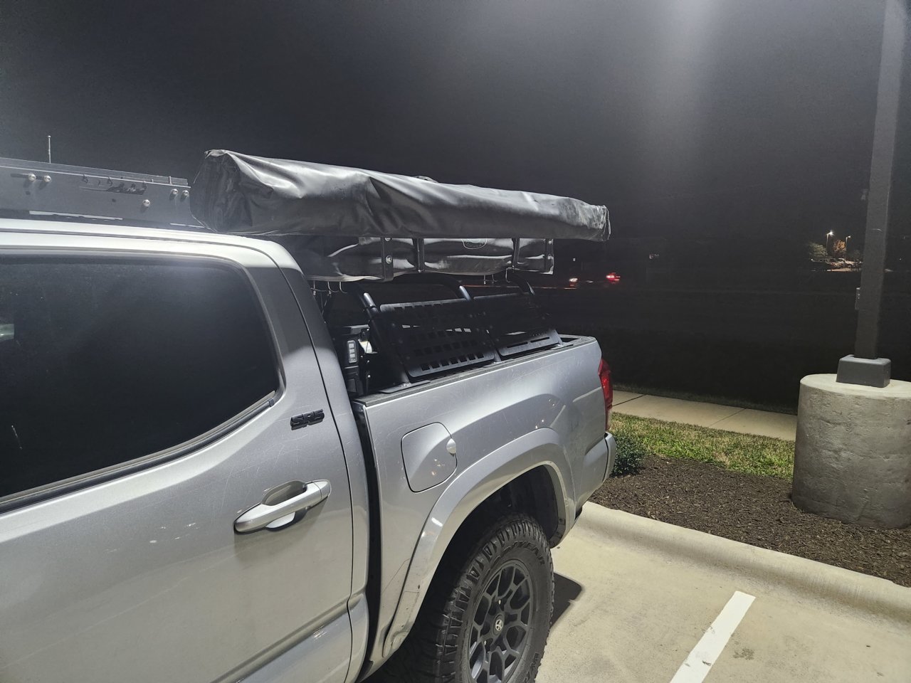

    Well, after what has seem like forever, an lots of ideas that at first seemed to be a something that would work. I figured out a mounting bracket for my 270 Degree awning. something stupid simple, yet took far more effort than one would think.
    Seems that there are not many off the shelf brackets for a midheight tubular bed rack.
    ran out of daylight, So had to get a couple pictures in a nearby parking lot.
    Still needs some bracing to help support the weight. I think I am going to cut some more of the steel I used so that I can create a shim, then I can slip the bracket under the tent mount and use the shims on the other side to keep everything level. I kept the brackets long So I can make sure I can get the cover for the tent on an off with out a lot hassles.
