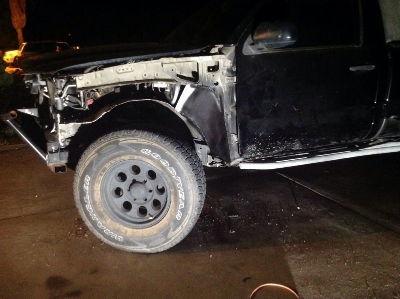

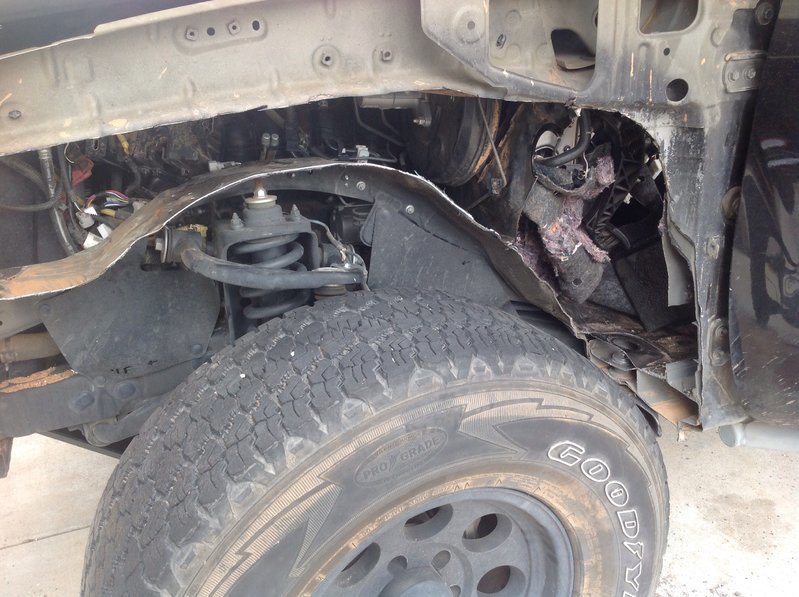

    image.jpg I'm currently right in the middle of tubbing out the lh inner fender.

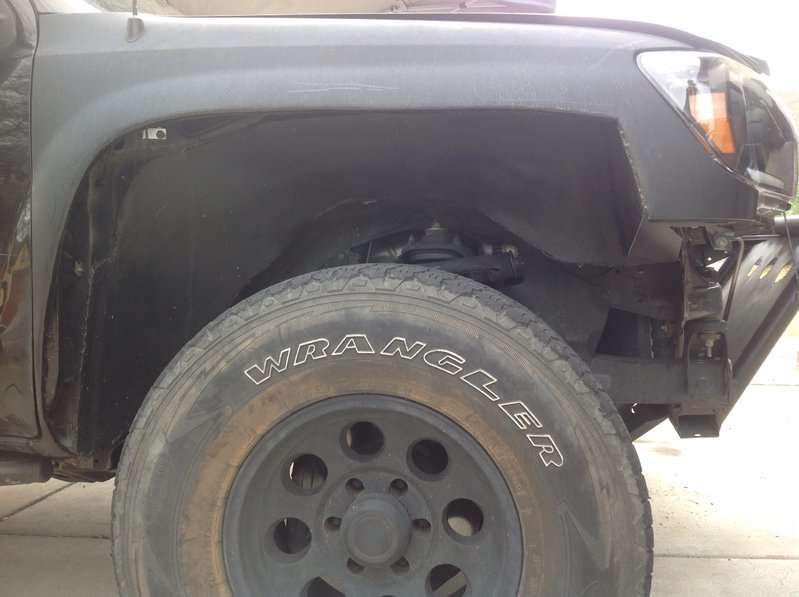

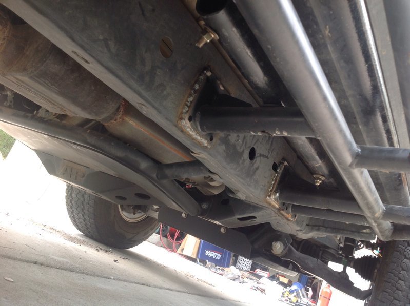

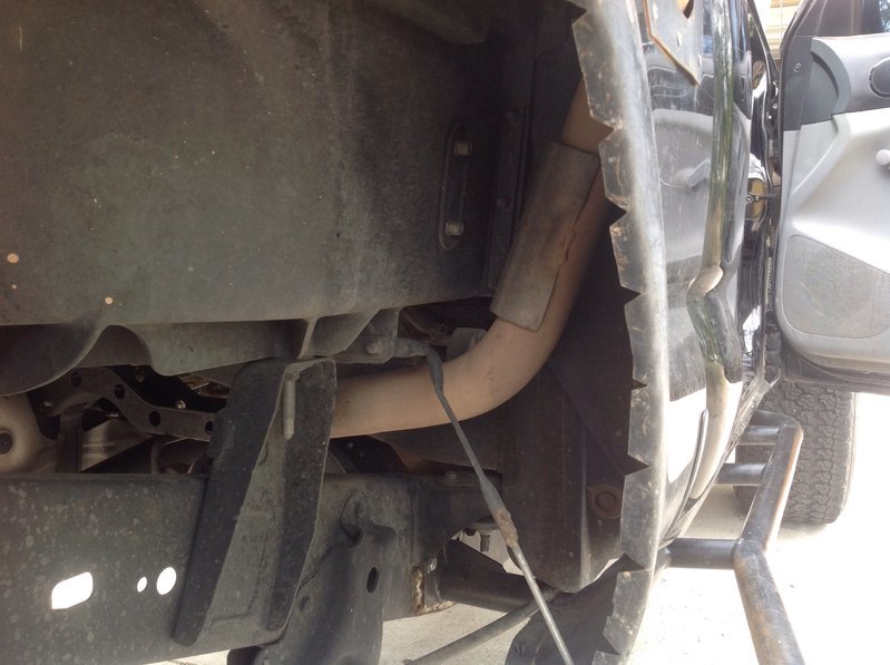

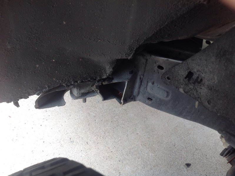

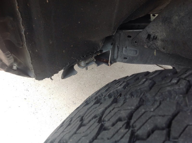

    image.jpg image.jpg image.jpg image.jpg It cuts into the fwd body mount but I've attached a piece of tubing to the top of some all pro rock sliders that I cut down to fit my reg cab. The tube ,1 3/4" .125 wall, is then mounted to the channel on the body under the rocker pnl with grade 8 bolts and rubber washers. It makes the ride rough but gives the support needed and then some.

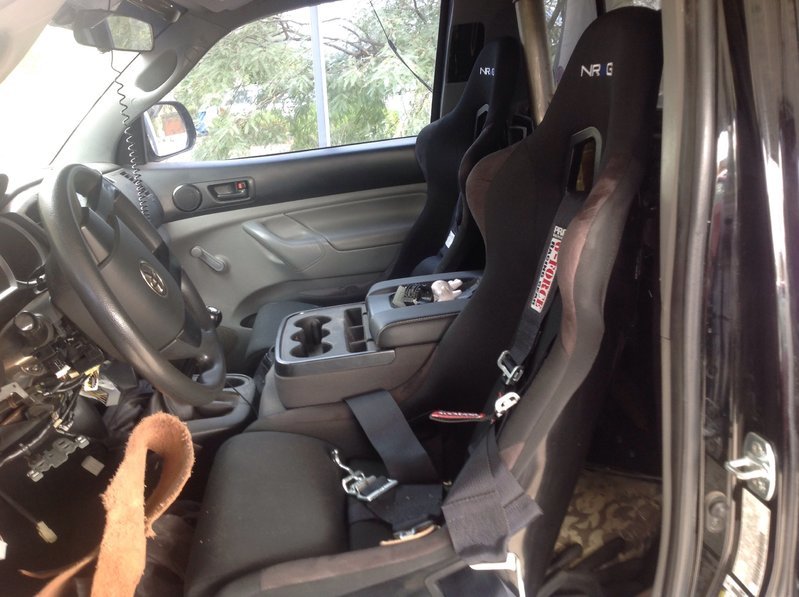

    I've also added nrg racing seats and g-force harness's along with a Chevy Tahoe center jump seat consul. I have not yet wired in the USB ports for charging phones but will soon.image.jpg

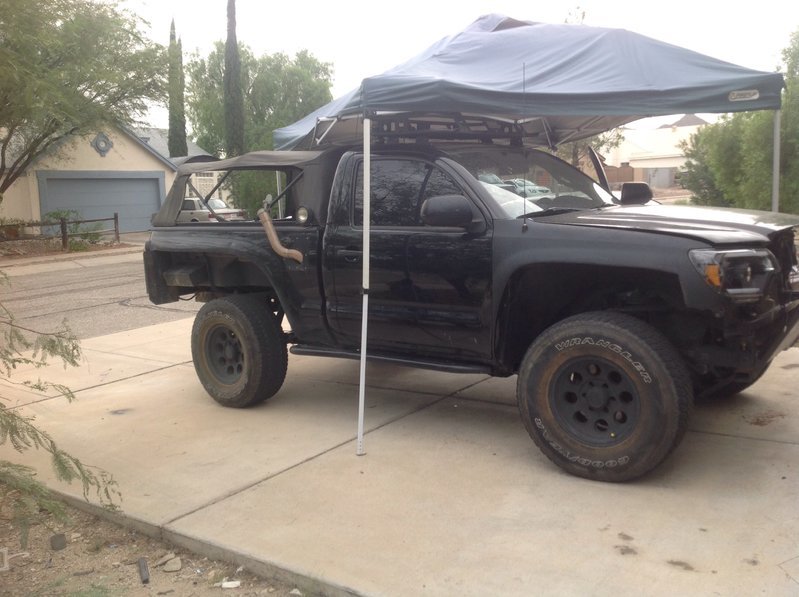

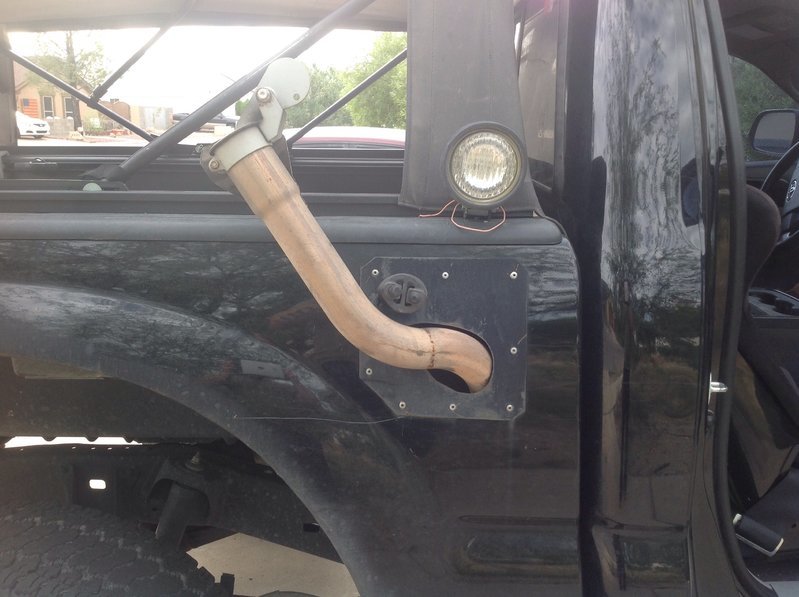

    image.jpg image.jpg image.jpg image.jpg image.jpg image.jpg I didn't like the arb snorkel so I made my own also when tubbing out the inner front fender I had to relocate the air cleaner. I opted to replace it with a Donaldson industrial off road filter that is located on my roof rack. The cfm on the air cleaner is way more than required for my 2trfe. This is one of the smallest air cleaners they make. It utilizes an air particle separator a large core filter and a large fiber filter. The ducting runs from the filter through the roof behind the passenger seat along the floor and through the firewall to the engin.

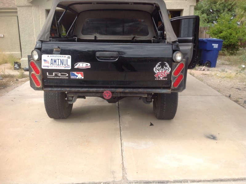

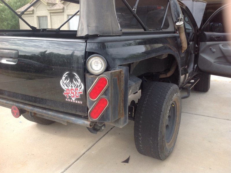

    image.jpg image.jpg I've also done a rear bumper rebuild and the rear lights. The backup lights are the floods on top.

    image.jpg image.jpg Everyone asks me why my filler neck is sticking out. This is in fact my exhaust. I have a URD cat delete program with a flow master glass pack and a super 10.
