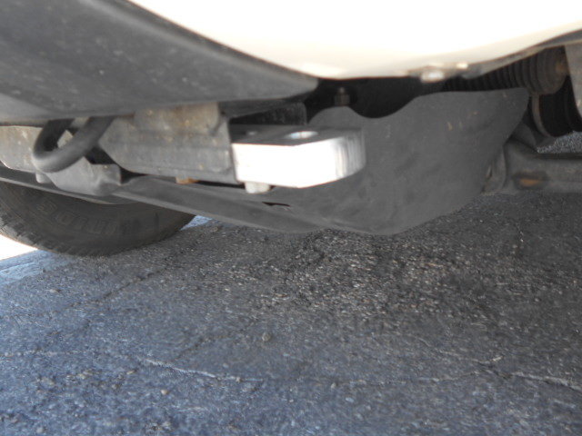

    OK - I'll bite. This works for me, mechanical engineers are known for their "reckless abandon"......

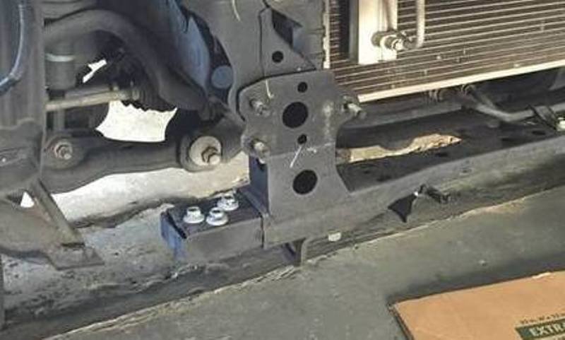

    This is the sheet metal box that holds the front cross member - for the front skid pan - under the bumper mounts. It has four sides and mammoth holes through all four. Given the right opportunity, I would weld them all shut or plate them over. They are designed to fail. The little sheet metal boxes bolted into the crossmember opening on both sides - have no known use.
    Visible in the photo is the edge of one of the "bolt-on" eyelets attached by bolts to nuts tack welded inside the frame. They have some use - but such devices are known to "peel off" when the load is extreme or eccentric. People on the site have reported that the loading of the internal nuts has puckered the sheet metal from the inside.

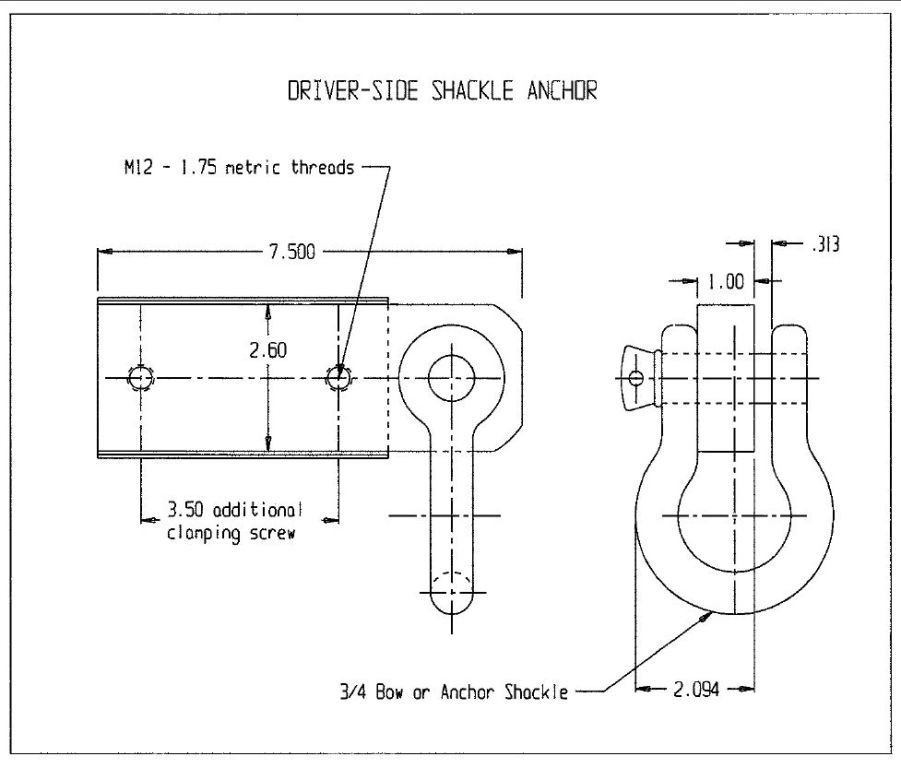

    So I built these to replace the little sheet metal boxes and anchor up inside the crossmember. The material is T6-6061 aluminum which is basically the same strength as mild steel bar. At one inch thickness, a load that would fail the eyelet would rip the little front crossmember right off the truck. Each is fitted tightly into the space, and the second bolt (drilled up through the sheet metal frame) is a 1/2-13UNC Grade 8 flange screw. I put a small hole to locate the frame hole and mark the aluminum - then removed the bar to drill and tap it. The frame hole was then opened to 17/32. If I build some more - I'll use 1.25 thick 6061 - just because it will fill more of the opening and still fit into the shackle. It will look even stronger and the ninnies won't wince. You could make them out of steel I suppose......
    After putting the big anchors in place, I got to worrying about the skinny little four sided sheet metal boxes that attach the crossmember to the frame. Depending on how you calculate it - they are good for maybe 10,000 pounds each - but I don't know the actual yield strength of the frame material. So - I put one on each side and got a "tree saver" strap to span between the two. The strap length has to be about 2-1/2 to 3 times the distance between eyelets to get some protection out of it.
    05tacomabro likes this.
