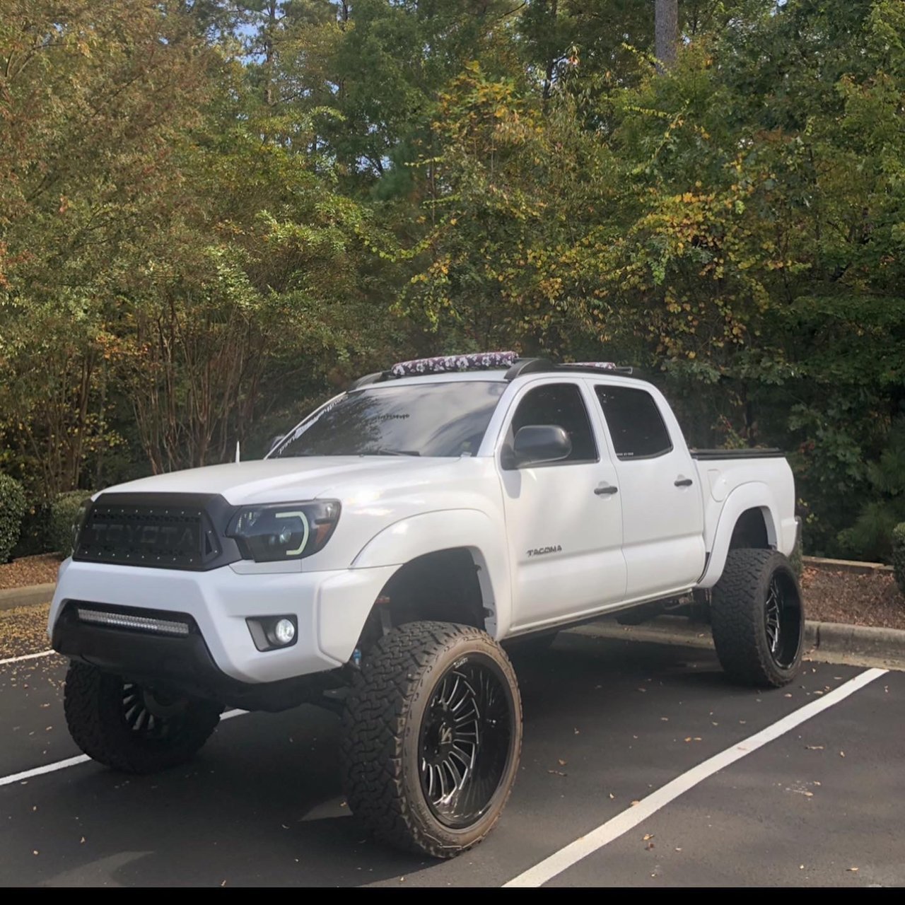

    Hey guys,
    I have a 2014 Tacoma, lifted 7” on a Maxtrac spindle. Its a 4” spindle (or knuckle), a 2.5” strut spacer and bilstein shocks set at .5 of an inch.
    I had purchased JBA’s Stock replacement arms when I had first gotten the truck, not informed of all the snowball effects that come with lifting a truck. After driving it now, I can definitely tell that the upper control arm needs work, as I need my caster back at stock angles and numbers.
    With this being said, I have done a LOT of research on JBA and some on Tuff country, but I am unsure if the Tuff country would fit my maxtrac spindle. I am leaning more towards Tuff country in terms of price and more my alley, as I dont offroad nearly as much as I used to, shes a pavement princess I know.
    Anyone have any clue if it would be the right fitting for my Maxtrac spindle? Can i use the Tuff countrys? Should i just go with JBA High Casters?
    Thanks!
    Joey
