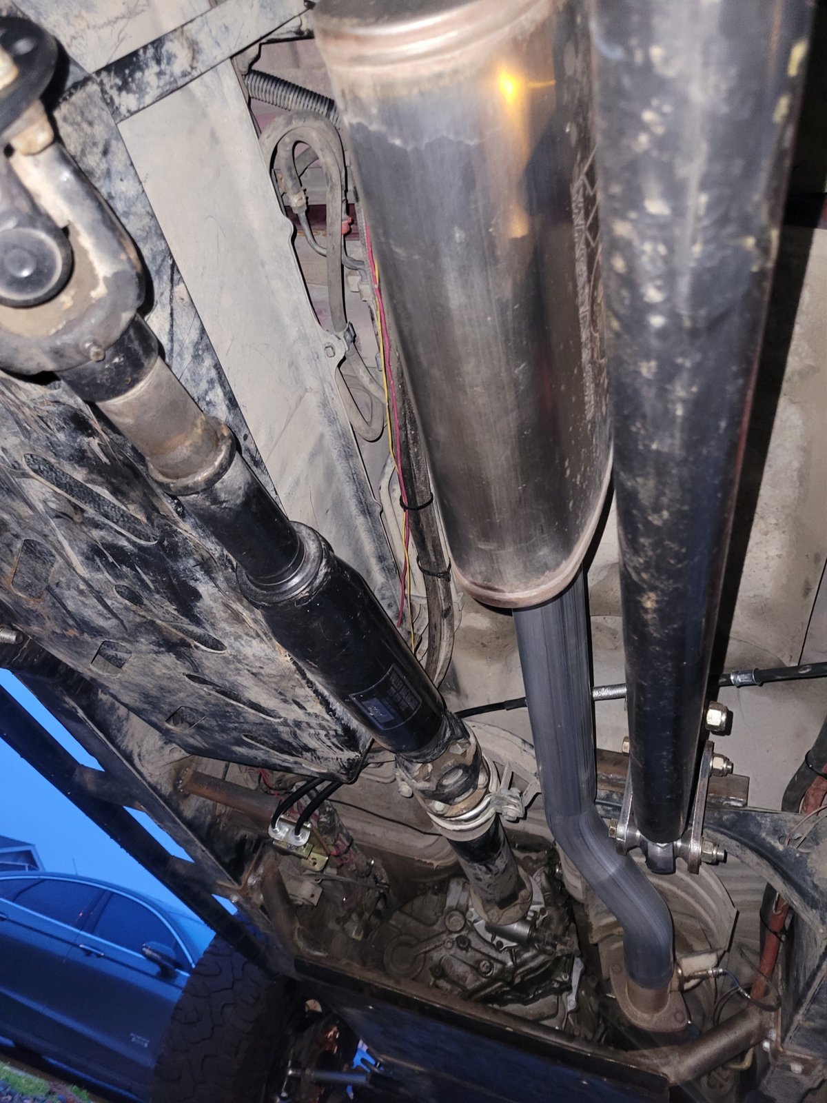

    Interesting. And ya, I guess I haven't paid enough attention to the space (or lack of) next to the tank... well dang. I'll take a look into Alcans again. It'd be nice to have a better ride back there vs the Dakars. Exhaust not an issue because it currently dumps at the rear of the cab so I'll be rerouting it back there eventually anyway.

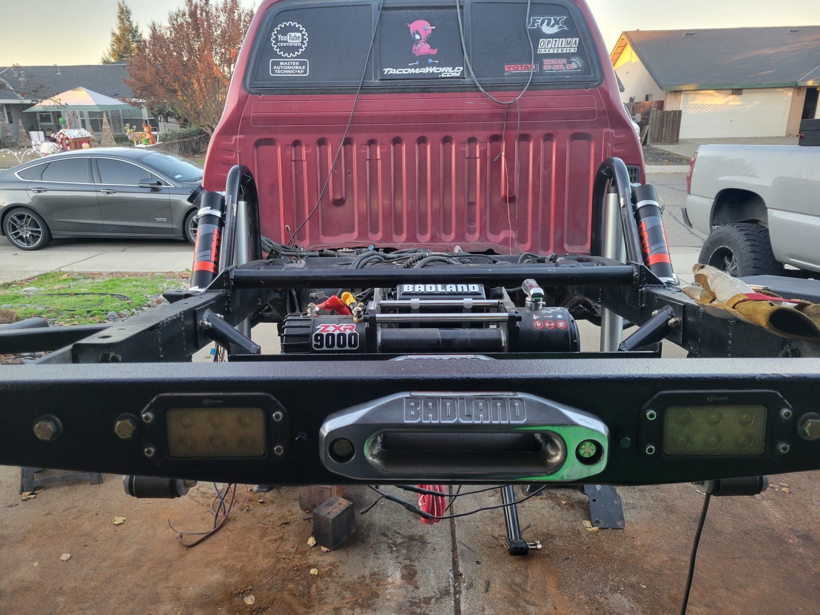

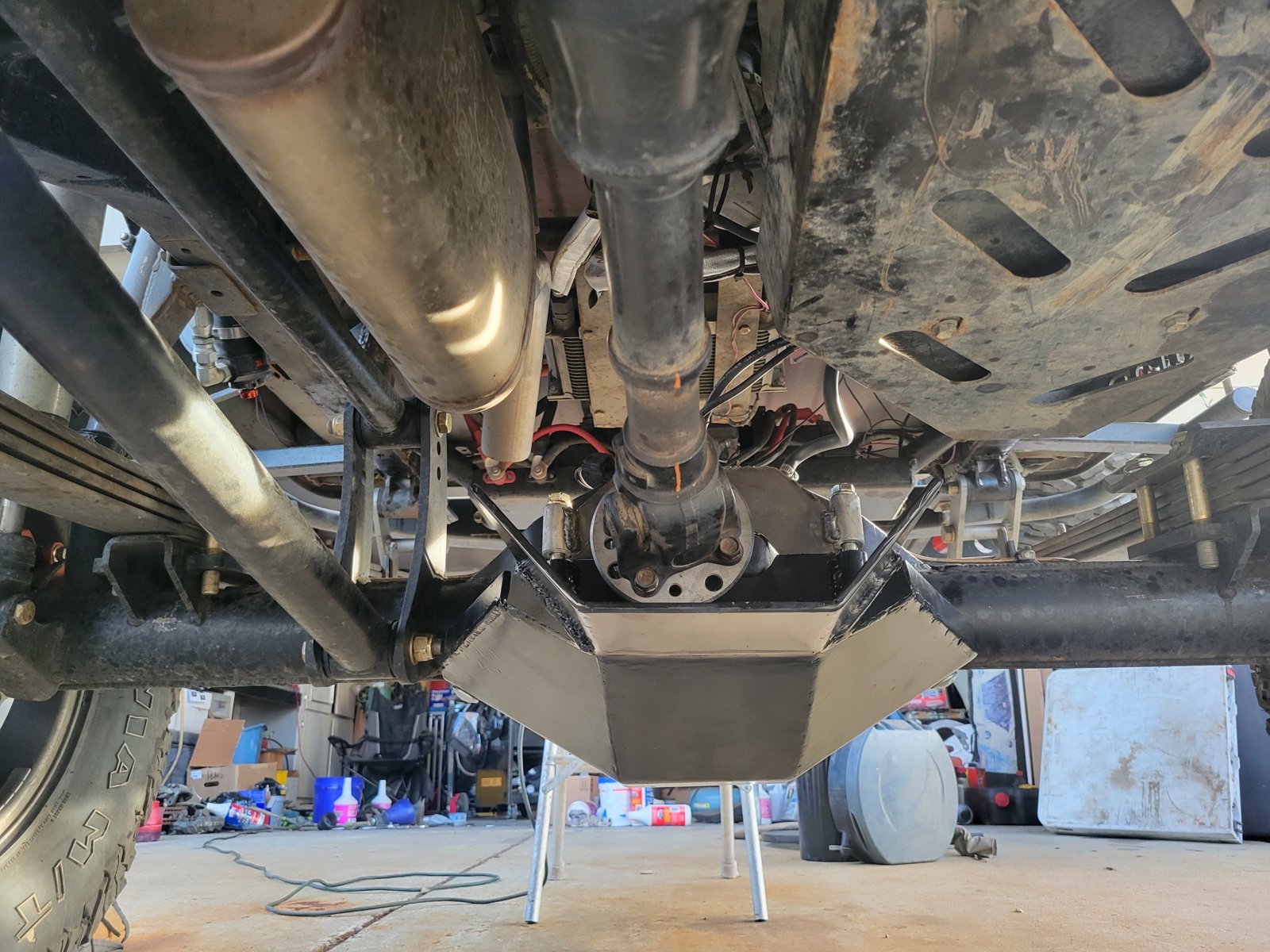

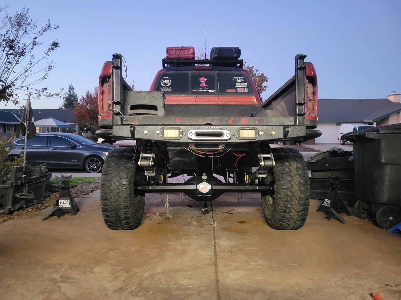

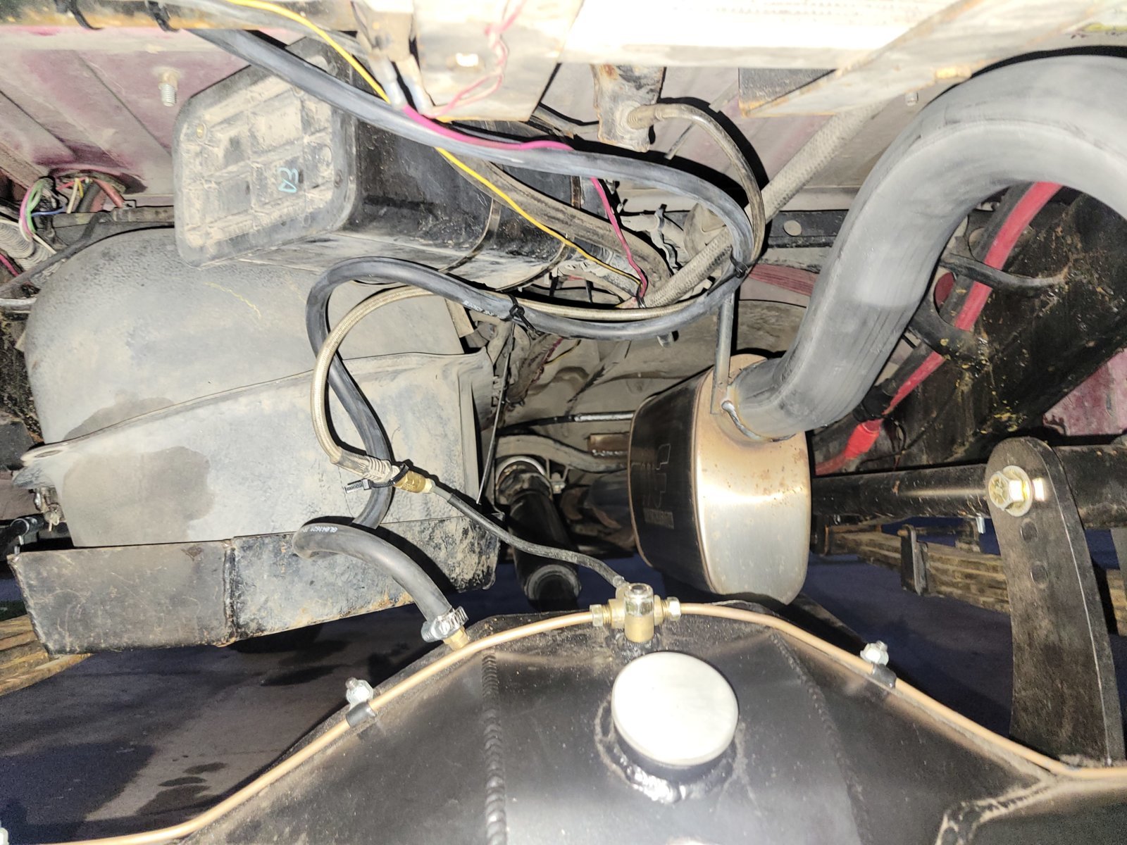

    That's the space you're working with between the tank and driveline. (My tank is actually relocated up 2 inches)
    Here's a shot back the other way.
    20240116_172916.jpg 20231123_131339.jpg 20231124_163203.jpg 20231127_170955.jpg

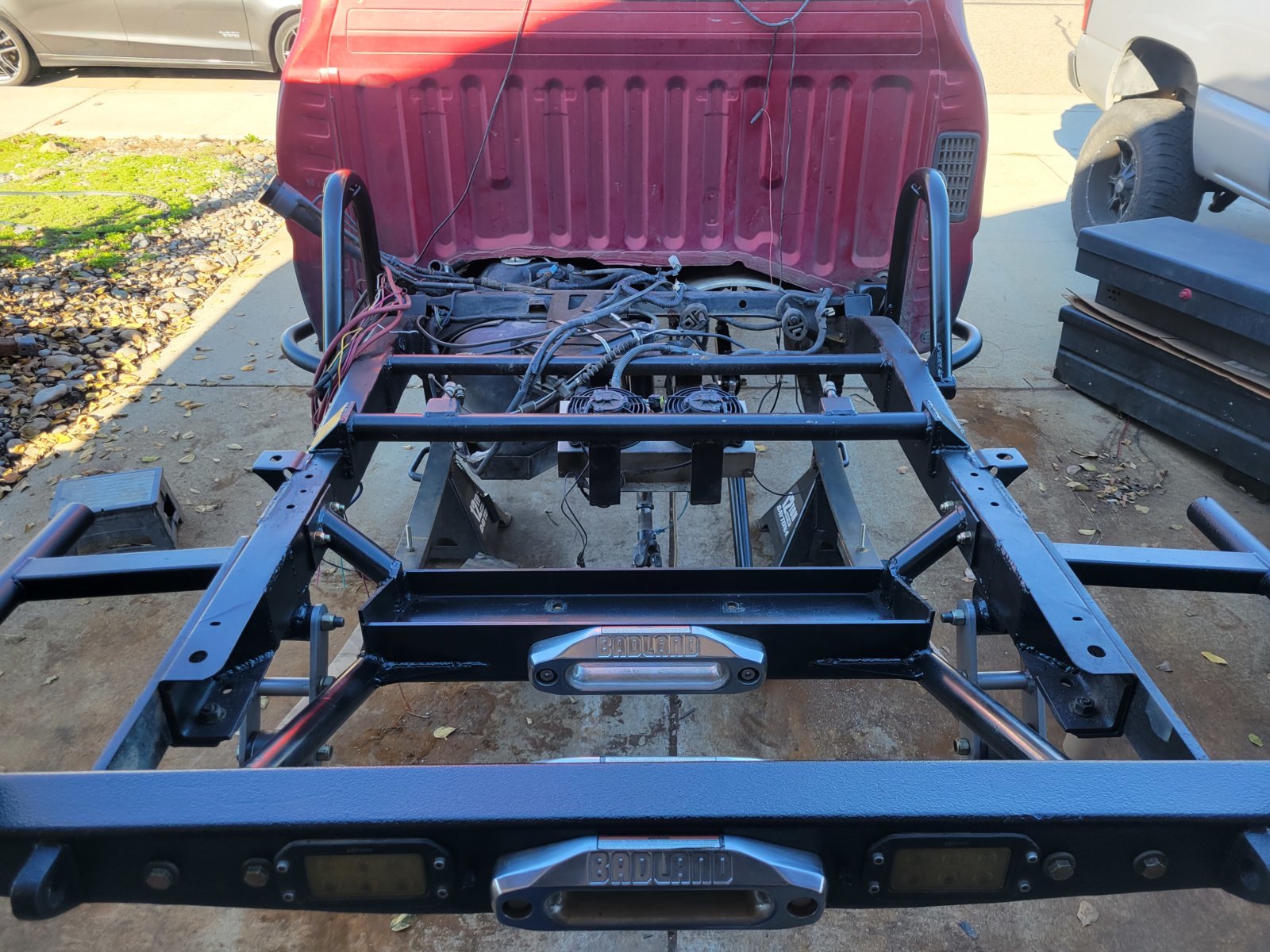

    And of course I had to shove 10 more pounds of crap in a 5 pound sack by adding a rear winch lol :rofl:

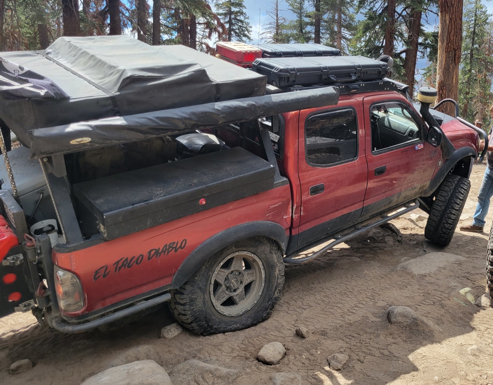

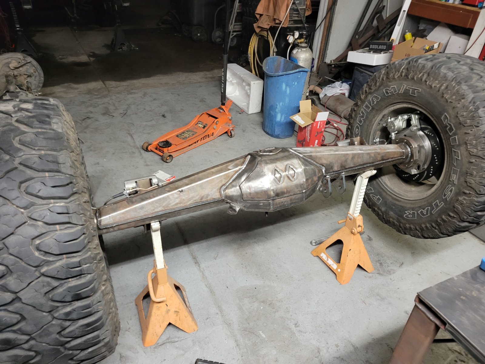

    Is it just me or does your axle have a slight downward bend on both sides?
    Looks sick though. What's the benefit of going longer leafs?
  4. Feb 14, 2024 at 9:16 AM
    #24
    El Taco Diablo
    El Taco Diablo Professional Pinstriper
    Nov 6, 2017
    #235223
    13,979
    Matt - KN6DZP
    Hughson, CA
    Impulse Red DC, 5vz-fe, 4wd swap, LT, dual case, F/R locked
    Just 3 tons of fun!!!
    Optical illusion with the way the light is on the truss on the back of the axle.
    That drove me nuts looking at it (worried about that). But the tubes are exactly straight. If they weren't, the axle shafts wouldn't have fit perfectly like they did. LOL.
    But good eye... I was looking at the same thing every time I looked at the back end of the truck from the garage.

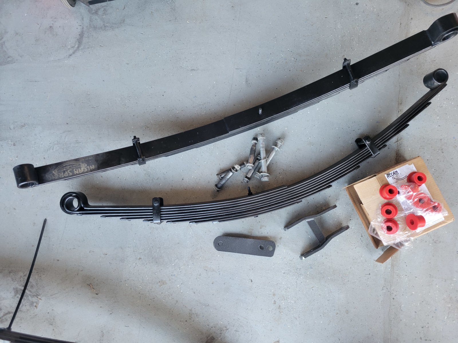

    The longer leafs SUPPOSEDLY get more droop. (That's what people say about 63s anyway). And they ride more smoothly (I will agree with that).
    The jury is still out on whether or not I hate the Chevy 63s to be honest.
    I also carry a bunch of weight on the truck. The 63s are a 1 ton set. (5 pack / thick). I started with 4 leafs, but I think I'm going to put the 5th in. It was too soft in back on my first test trip, (King of the Hammers) and bottomed out too much.

    Here's what I mean by truss on the back of the axle housing.
    The truss isn't perfectly level with the ground (can't be) due to how it matches to the bends on the pumpkin, and the angle of the pinion.

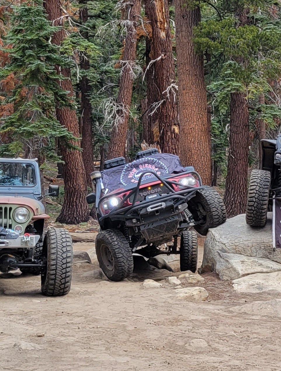

    Too bad you're not closer...
    I have a set of Alcans, with brand new bushings and adjustable shackles for sale lol.
    Alcans are WAY better than Dakars.

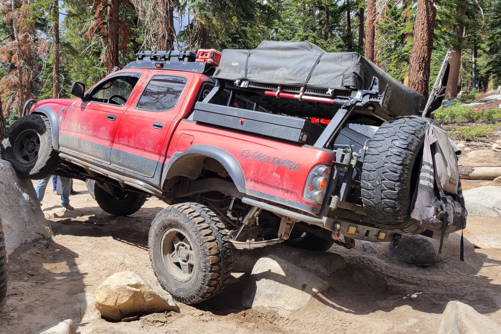

    Here's the Flex they were giving me.
    Those are 35s. And that's a shorter (width) axle.
