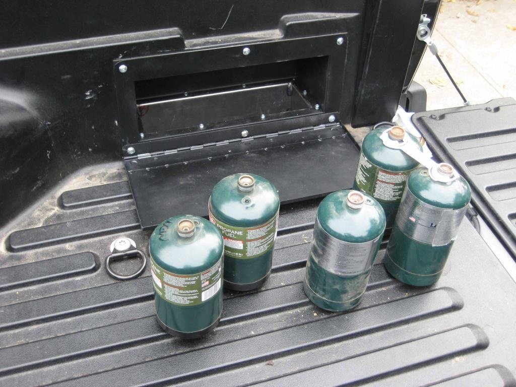

    I am currently working with a sheet metal shop, and they should be sending me CAD drawings and pricing within the next two weeks or so. Once I have that info, and decide it is a worthwhile endeavor, I will post pics and pricing.
    Just to give you an idea: It will hold five 1lb propane canisters...
    One thing I have found out: not very cheap to manufacture. Even the Tuffy probably has a mfg. cost of at least $130.... material and mostly labor. Then add in the cost of the lock, powder coating, and then the packaging. Which is why the Tuffy retails for about $200.

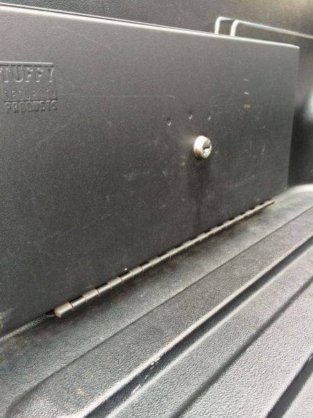

    2 yr update on the Tuffy Box. There's maybe a little rust on the hinge if you really look hard. It's never leaked water even using a power washer. I spray WD40 in the key slot every year. It's been working great. The main thing I use it for now is if my truck is going to be parked for long time (at the airport, sports games, etc.) i'll place my expensive stuff in there. I'm not saying it's more safe than inside the cab. It's just what I do so I feel like I actually needed to buy this thing.

    Unless your box design is final assembled while already in place (or something), you may want to check twice about not having the sloped top... It seems to me that its there on the Tuffy simply so the box can be installed thru the opening in the bed box. I have two of the Tuffy boxes and I can say for certain that they would not have gone in without that slope being there.
    Pic #5 in the OP is just about as far as the inside of the fender allows you to insert the box. From there is it tilted into place, and even with the slope it was a close shave on the passenger side for me.

    Dry as a bone man. Going on 2 yrs and it's never leaked water one time. I check it after each car wash too (just out of curiosity) and it's dry.

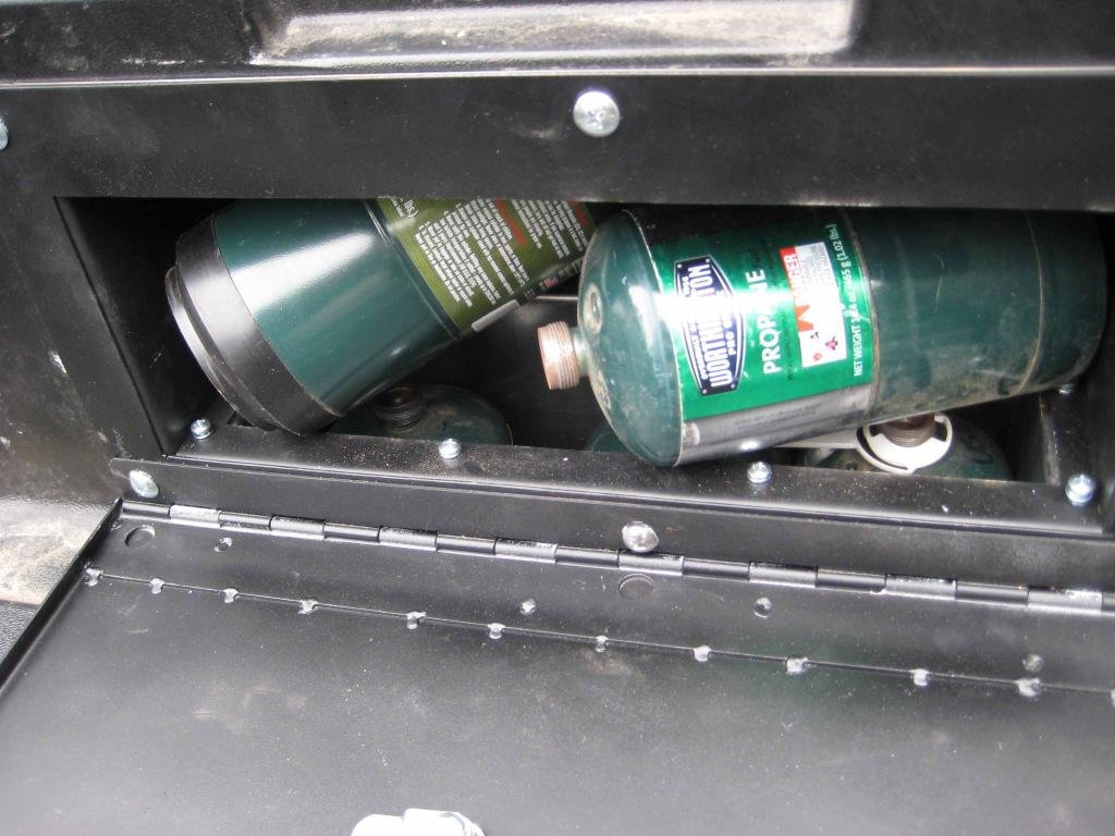

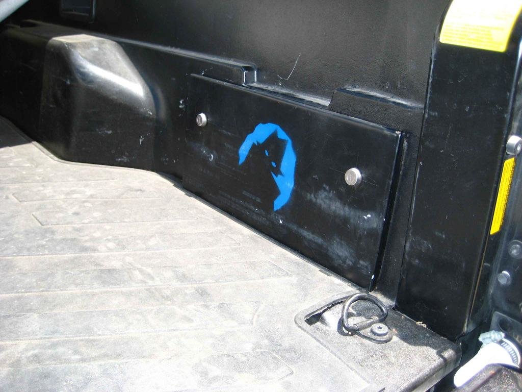

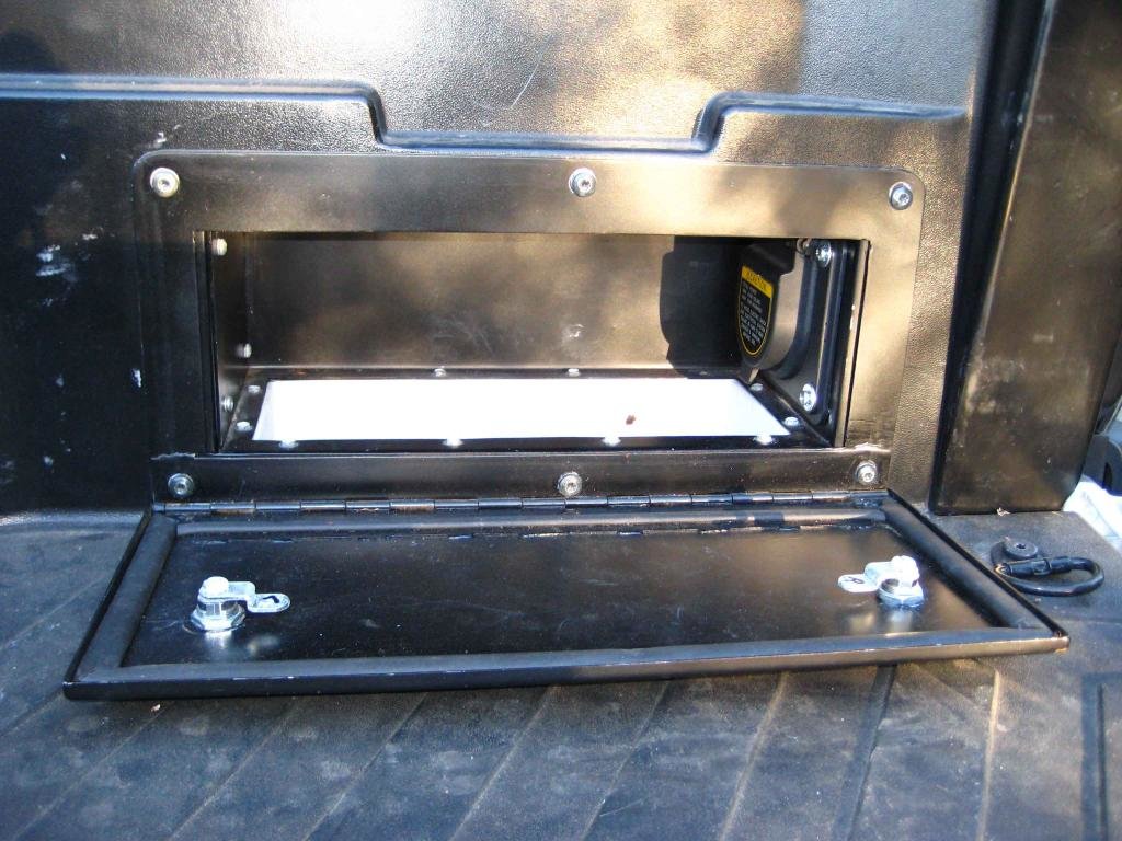

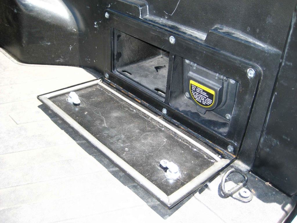

    So here are some pics of prototypes I have made; It is a modular design where the locking door is separate. Use / buy just the locking door to lock factory plastic toyota boxes, or buy both the locking door and large capacity storage boxes for the ultimate locking capacity. And you can install one on the passenger side.... and install your power outlet behind the locked door. There are also "cover plates" if you do not have the power outlet.... on both ends. These can be used to mount quick-connect air fittings, 12v power outlets... what ever you might want. These boxes would also make a great place to mount a VIAIR type of air compressor, inside or on top of the box (my plan when I have time).
    Again, these are prototypes..... Locking doors and hinge will be stainless steel.
    Any feedback / interest in purchase is welcome.

    Impressive man. 5 propane bottles worth of storage? Wow!
