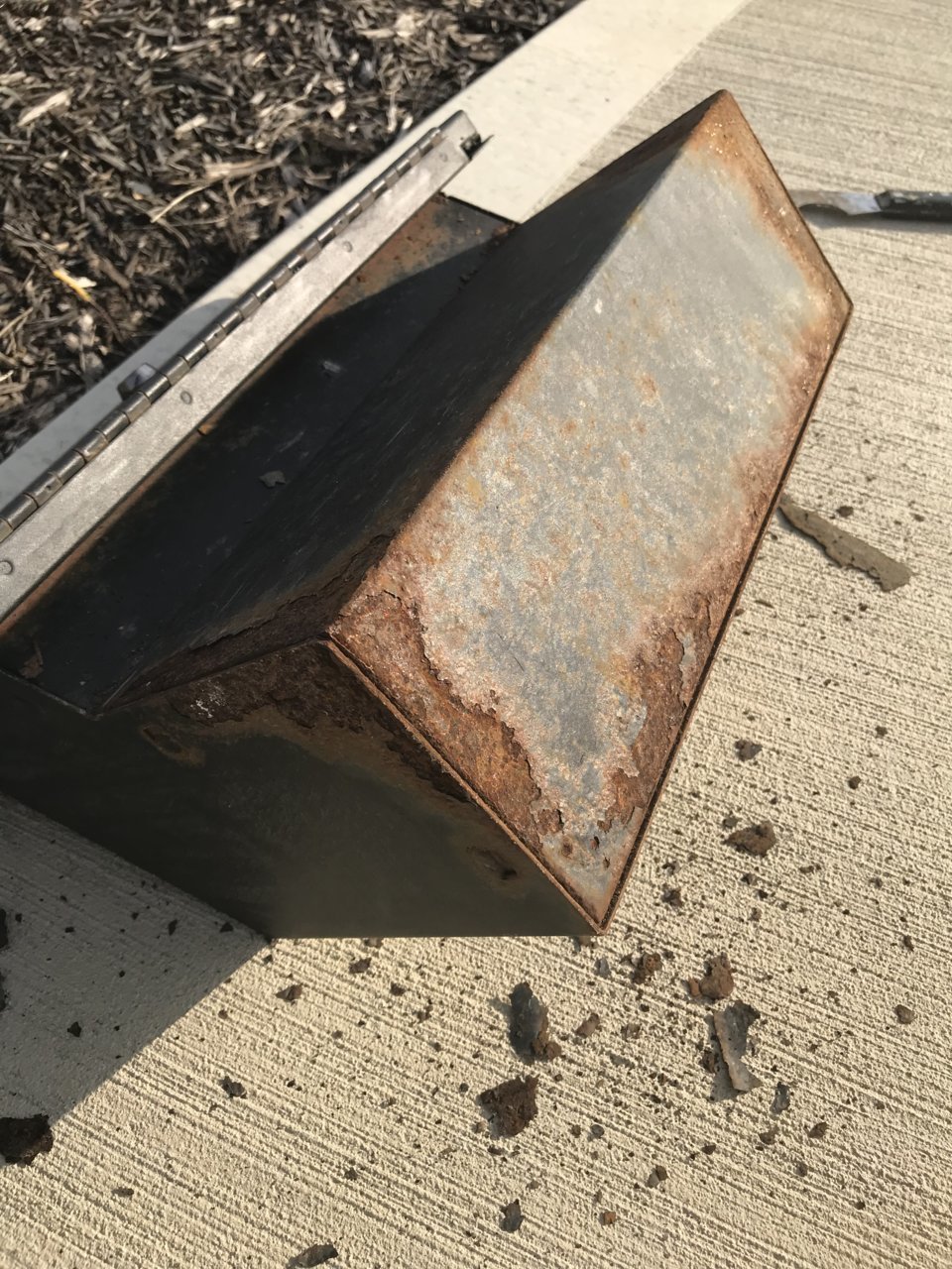

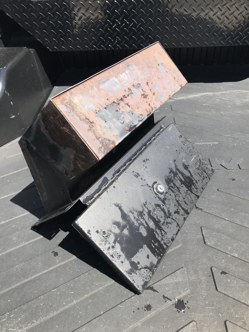

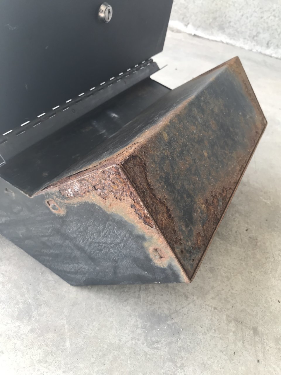

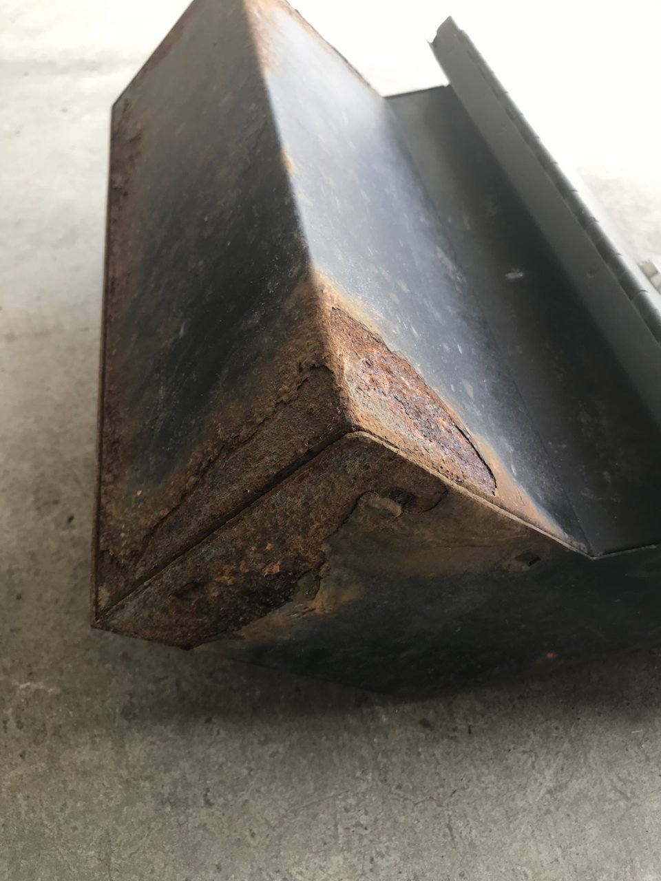

    Took it out after 7 ish years? Surface rust all over the outside. The inside of the box looks decent but I can’t tell for sure. Going to sand, prime, and repaint this spring.

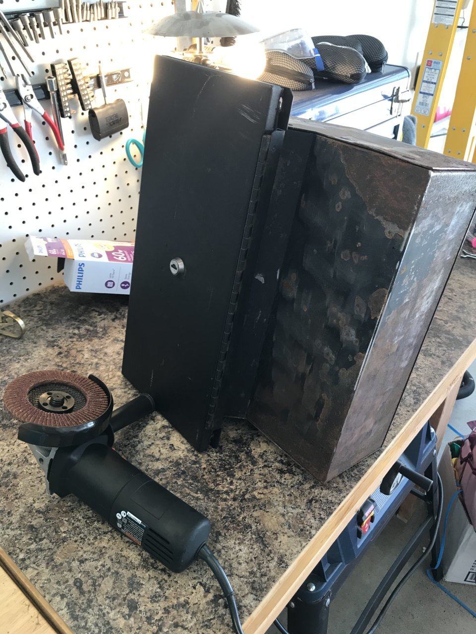

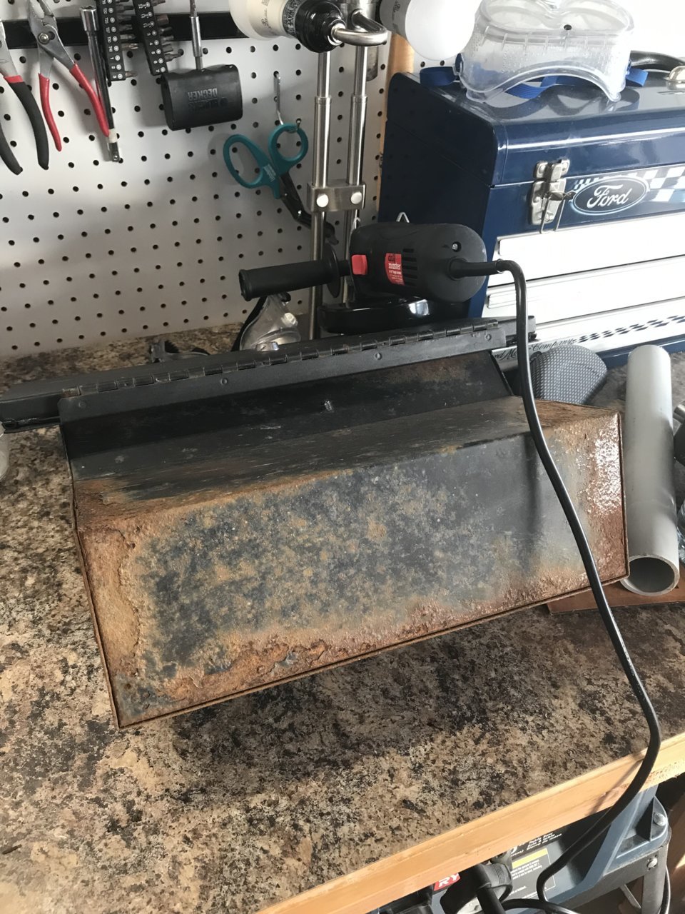

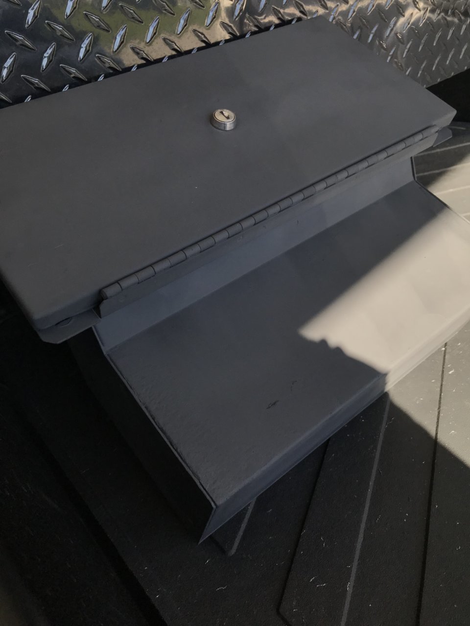

    Going to see if I can make it work another 7 years. Grinding and cleaning done.

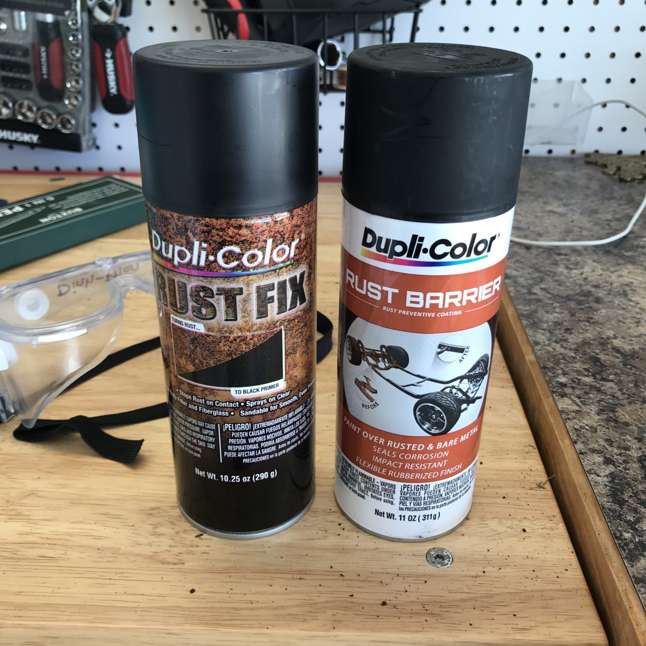

    Rust converter?

    I bought both of these. One is a rust converter. The other is used for rust on vehicle frames to prevent rust from spreading.
    I’m really just trying to prolong the life a little longer. The inside of the box was really bad also. And i couldn’t fit my grinder/sanding disk in there very well.

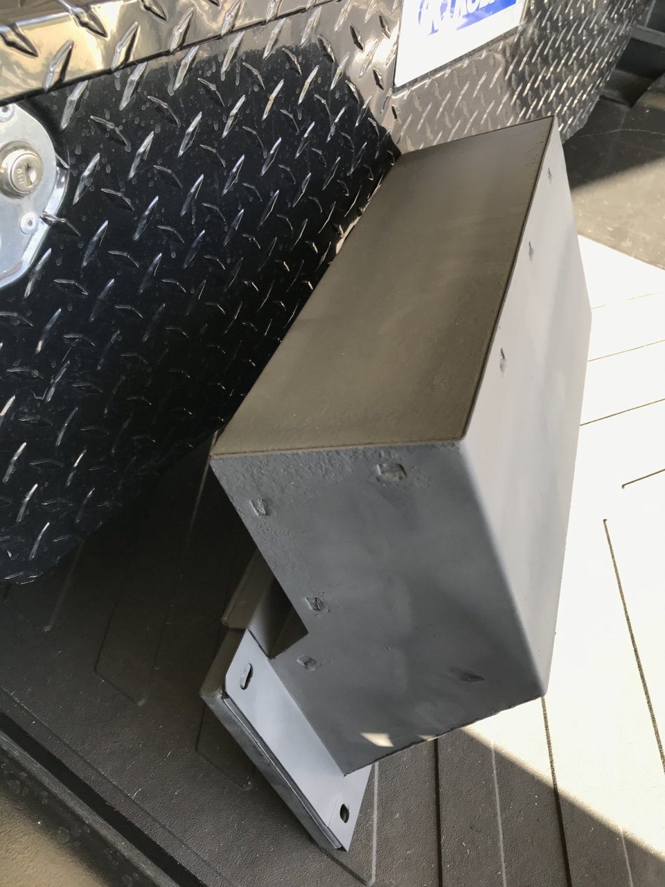

    Sanded, scraped, washed, rust fix and then barrier. Hopefully it lasts another 7 years. Just got done installing it.
    Honestly I don’t really have a use for it anymore now that I have a large toolbox. But it’s still kinda cool.
