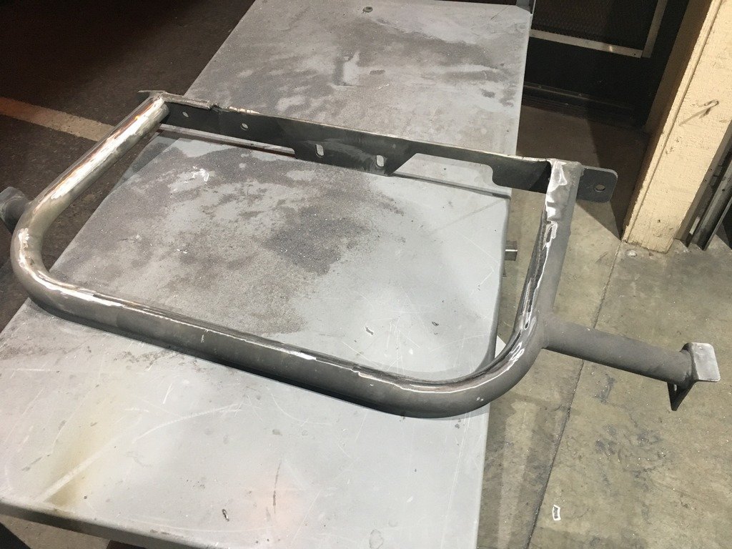

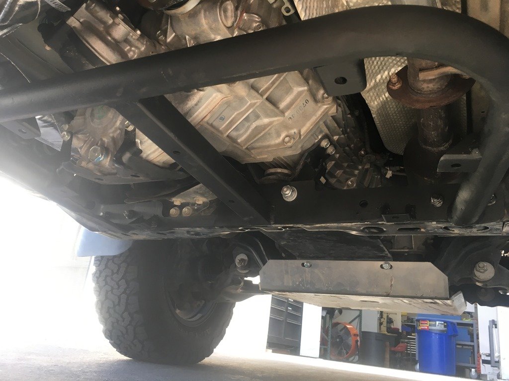

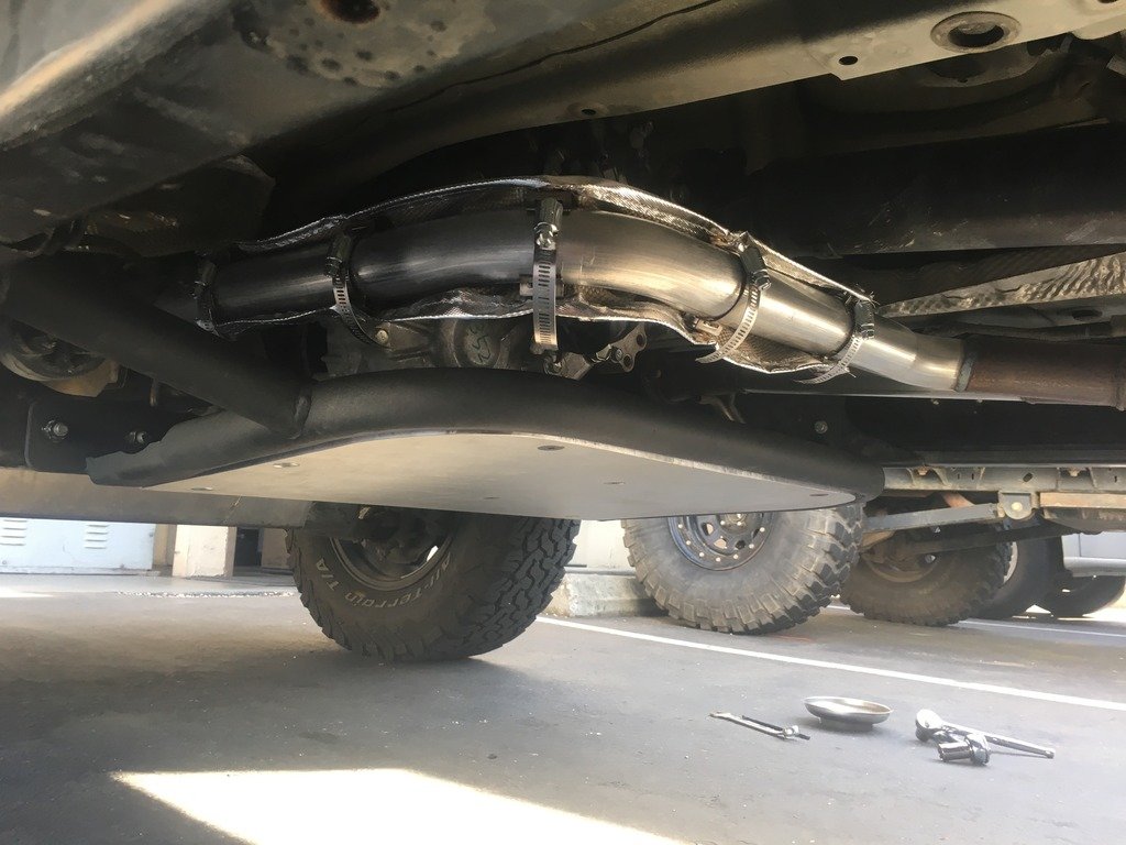

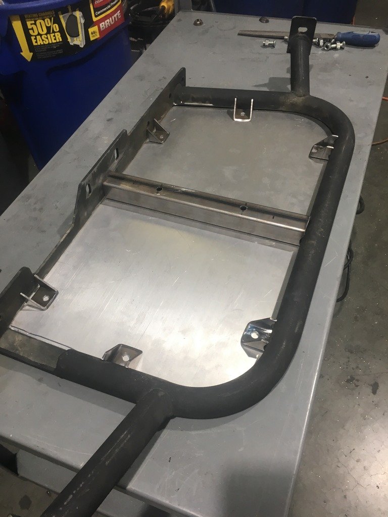

    I finally had enough bashing of the All Pro transfer case skid, I just couldn't take it anymore. I probably will go back and shore it up a bit more but for now I am happy. Skid is 6061, sits smooth with the sub frame, gained about 3" where I needed it most, and removable from the bottom without dropping the All Pro frame.
    If you're thinking about a transfer case skid and debating on committing to a reroute, do it. The clearance is way worth it and you don't have to do it twice.
    Skid removed, exhaust rerouted:
    Hack job on the skid
    New brackets made ready to be burned in

    Nice, got anymore pics of the exhaust reroute? I need to get that done before getting the skid. Where did you get the heat shield for the reroute?
