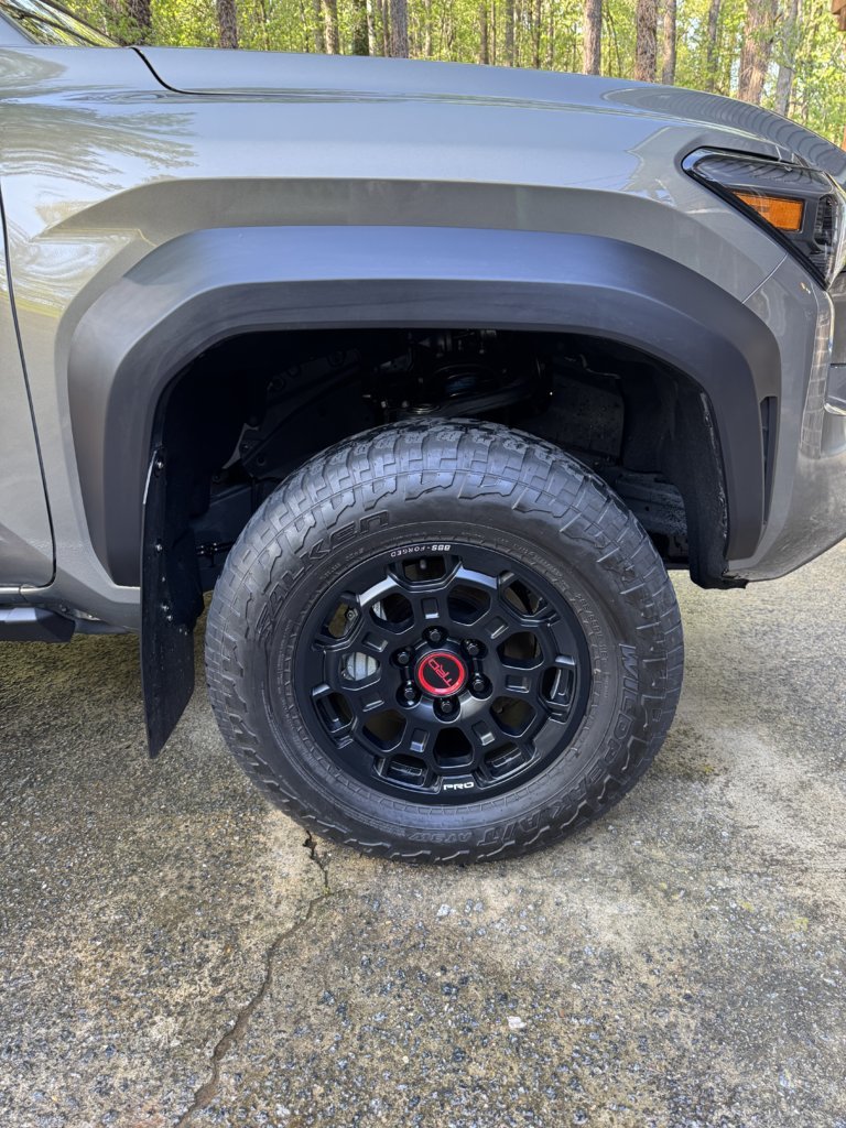

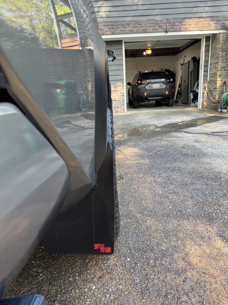

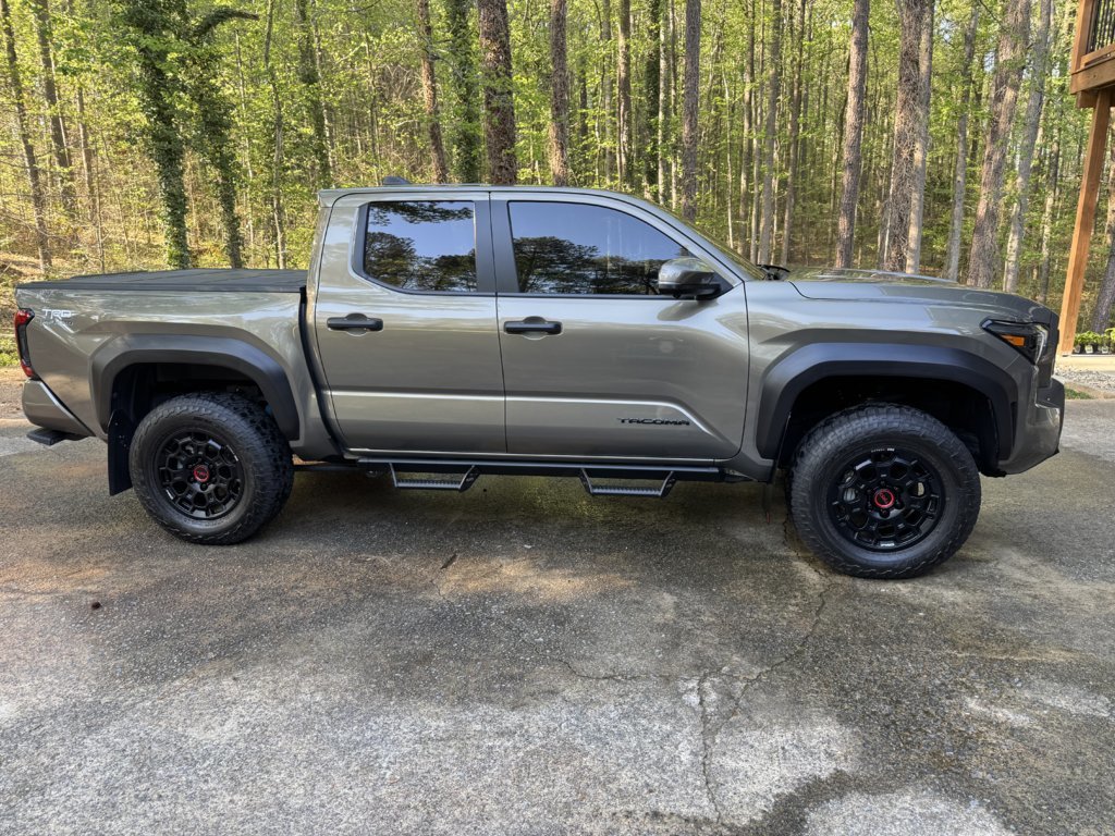

    Found a set of these after watching my local
    FB marketplace like a Hawk. These had about 1800 miles, so got the tires and wheels as takeoffs from a new 2024 Sequoia TRD Pro. Had them installed today and they look great on bronze as well.
    Tire size is the OE Falken Wildpeak AT3w in 285/65-18. Considered a 33”, they’re almost exactly the same size as the 285/70-17 tires I took off. These Falkens come with only 7/32nds tread depth when new, so they’ll be a short-lived tire. The wheel is 8” wide and 27lbs. I expect my mpg will go up as the wheels are lighter and now just tucked into into the edge of the fender flare.
    Super happy with the style and look. Thanks @CrispyTacoLover for posting these up.

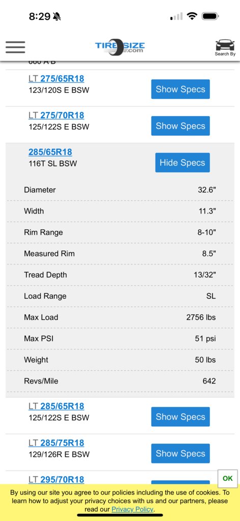

    IMG_1047.png I’m
    The guy at the shop that did the install was telling me that these Falken Wildpeak AT3w tires that come on the Tundra and Sequoia only have 7/32” tread and are a softer compound so that they’re quieter. They’re an SL rated tire, too. Mine have a couple k miles on them, but are basically new and I expect to maybe get 10-15k out of them. They ride super nice, smooth and quiet though at 75-80mph on the highway.
    An aftermarket AT3w in 285/65-18 SL weighs 50lbs, my guess is that these would be 47-48lbs.

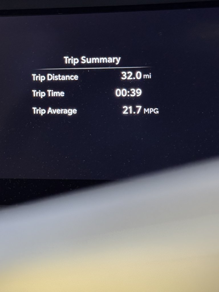

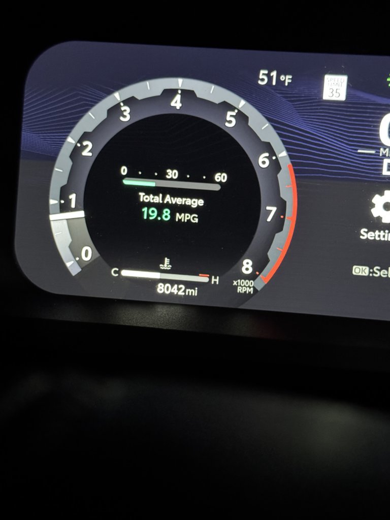

    I don’t… I have a scale in my shop, I’ll pull one of them or off and weigh the wheel and tire combo. Everything I have found shows that they’re about 27lbs.
    My mpg has gone up significantly with this wheel and OE tire setup. I was averaging 17-17.5mpg went the aftermarket Black Rhinos and 285/70-17 Ridge Grapplers and am now averaging 19.5-21mpg on the same daily commute. The Black Rhino setup was ~78lbs per corner.
