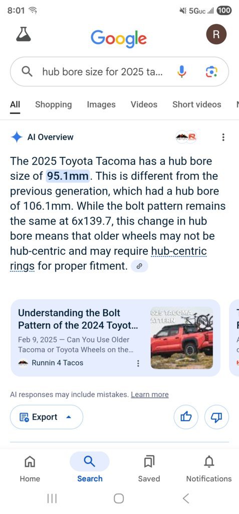

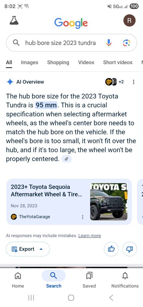

    I wasn't 100% sure but according to the online Google search answer ( a i) , that insignificant .1 does matter .Google it .I just needed the OP to confirm

    Probably a discrepancy in your findings. All of the late model Toyota wheels are using the same hub bore. I didn’t do anything to mine.

    AI isn’t always right but the confusion is probably that the vehicle hubs (Tundras and Tacoma) are 95mm and the wheel hubs (holes) are 95.1mm.

    Thanks for clarifying there's nothing better than to actually ask someone who's had first hand experience. On the other hand beware of false info like I experienced when I asked Google the same exact question on 2 different vehicles .
