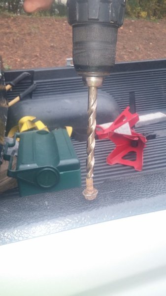

    I'm pretty sure it's for any first gen and
    Yeah they bolt right up you just have to take a few threads off the banjo bolt. I put the banjo bolt in a vice and used a 3/8 drill bit to drill it out.

    That may be the part I'm having trouble visualizing. Is it like the photo on this page, you removed the line, drilled it out a little bigger at the fitting and then sourced a new bolt to screw into the caliper?

    Hope this helps. You just need to make the banjo bolt shorter so it will sit in the caliper all the way. You could probably cut it with a angle grinder if you had to.

    Thanks, that helps. If I do this mod I may try to source a new bolt first to butcher. I can see myself trying to hack the original bolt and wind up being without the truck for days.
