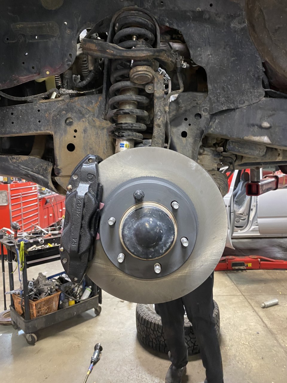

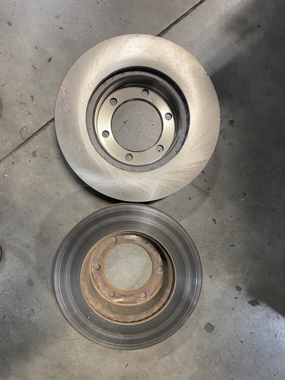

  3. Oct 31, 2022 at 8:26 PM
    #23
    Trail.Tuner
    Trail.Tuner [OP] Member
    Aug 17, 2022
    #403761
    5
    Tykie
    2003 Red Tacoma Trd Extra Cab
    Finally got around to installing them and 2 days later went to Moab to put them through their paces! They are a must if you have anything above stock sized tires. No more jamming the pedal into the firewall with all of your weight to gently come down a ledge or rock! So much more controlled. 10/10 recommend! Install was super straight forward besides the hardline being a huge pain behind the frame considering the nut was seized on the passenger side. Installed the adventuretaco braided adapter lines and the work like a charm.1755A164-C29D-4F20-9A70-A56F583B1139.jpgCBA97E4A-C052-4BAC-83C0-FB6876093BC1.jpg
    turbodb and Front sight like this.

  5. Nov 1, 2022 at 11:53 AM
    #25
    Trail.Tuner
    Aug 17, 2022
    #403761
    5
    Tykie
    Still a softer pedal than you’d have with stock but that’s to be expected with bigger brakes and the same master cylinder. It’s not so soft that it’s intimidating or sketchy to me at all. The biggest thing that helped the pedal feel was adjusting the rear drums ensuring they were actually doing something too!
