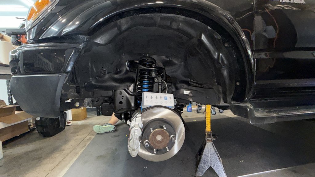

    All I can say is that the deceiptions of the soft pedal are so common and so specific/identical, it’s hard to think it’s anything but the obvious need for a bore MC. Just finished mine with the adventure taco kit and Amazon caliper - Toyota everything else. Replaced really the entire front suspension with OE’. We bought the truck new in 03 and intend to keep it. Great instructions from adventure taco and the kit is great. I would love some options for larger MC, if anyone knows.
    I have the same as everyone else. First pump goes waaay down before any brake but if you give it a second pump, it firms up a bit.
    options?

    PS here’s a pic.
