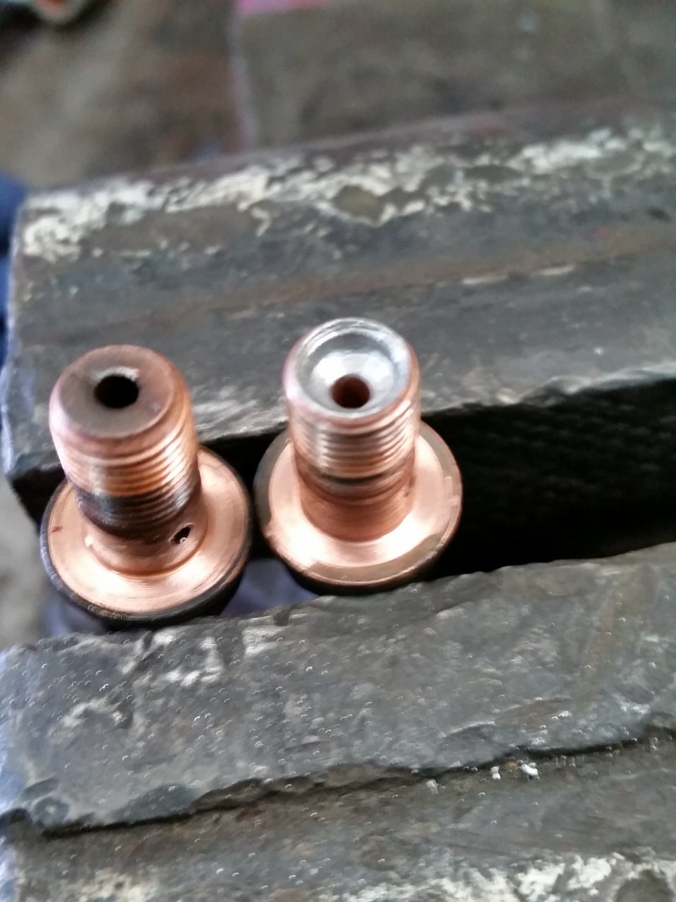

    You can drill the end of the banjo bolt out a little. You could try another copper washer. pic coming of banjo bolt mod.

    Don't have to drill nearly as much as i did. Usually just the taper of the drill bit is enough

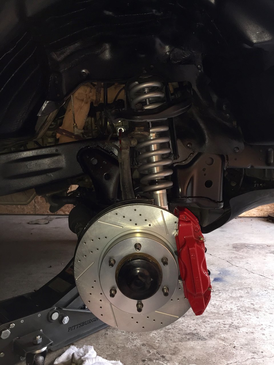

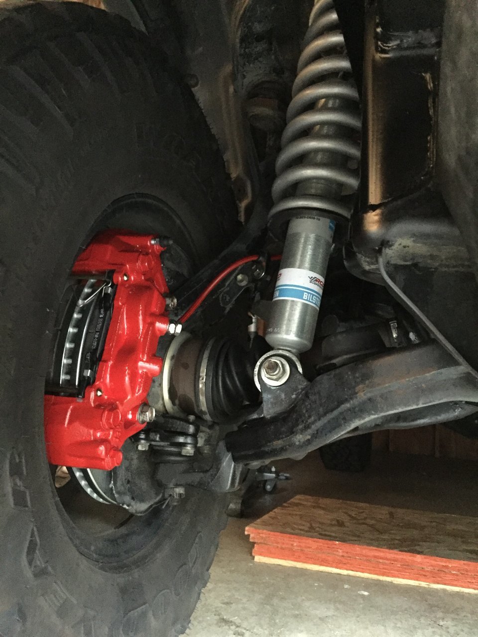

    Couple of photos from the install!

  12. Feb 18, 2018 at 9:27 PM
    Tyler Andrews
    Tyler Andrews [OP] Well-Known Member
    Feb 23, 2013
    #98260
    209
    Tyler
    Portland
    2018 Super White Sport 4x4
  13. Feb 18, 2018 at 9:27 PM
    Tyler Andrews
    Feb 23, 2013
    #98260
    209
    Tyler
    Portland
    There you go, bud
